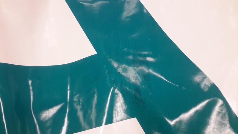

We have printed ferarri media using a HP L28500 and laminated it using a liquid laminator machine and 'ArhivaCoat waterbased matte' and we are experience ink transfer and peeling/stickiness of material upon receipt.
The media and laminate is perfectly dried and cured when it comes out of the laminator but it is becoming sticky and transferring when the client opens it.

I'm not familiar with Ferrari media, but it definitely sounds like the liquid laminate is reacting with the media. You could contact Ferrari and see what they recommend. Probably need to find a new laminate or new media.

I have some ArchivaCoat and tested it on a cured latex print and it didn't produce the same result. Are you sure the Ferrari media is not expired and that the ink is fully dried and cured? You may have found an incompatible combination if everything else checks out.

AF thanks for trying out ArchivaCoat with latex and confirming our suspitions that it was the media.
I know that the media is not expired as it is coming from the manufactuer directly so it must be the top coat on the fabric.
