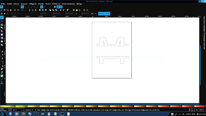

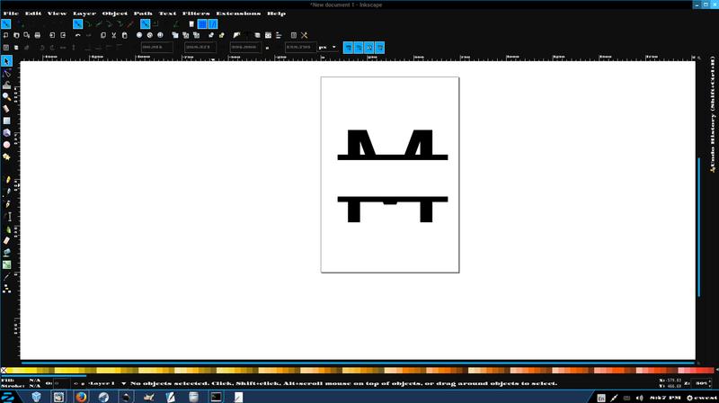

Inkscape can do that. Just have to use it's pathfinders tools in the path menu.
Mainly Division and Union.
