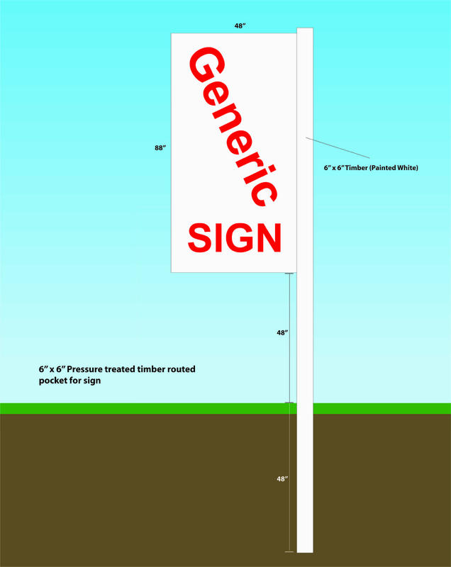

I have a customer that provided the following design to me asking if this would be possible. This will be a temporary construction sign. Well, I said.. Anything is possible.
When I look at this design, I see some problems. First, with the 4x8 sheet of 3/4 mdo inserted into a 6x6 post. Not a problem doing it, but, I think that when the wind gets ahold of that sheet its gonna bend and rip it right off of the post. This sign is suppose to last 14 months. I mentioned using the post and banner poles extending out from the post supporting a banner with pockets. He wants more of a professional looking and more permanent looking sign then the typical construction sign. Any ideas or suggestions would be much appreciated. I can see what hes trying to do, get away from two posts, kickers, generic construction signage. What have some of you all done to mix it up a bit. Thanks all.
