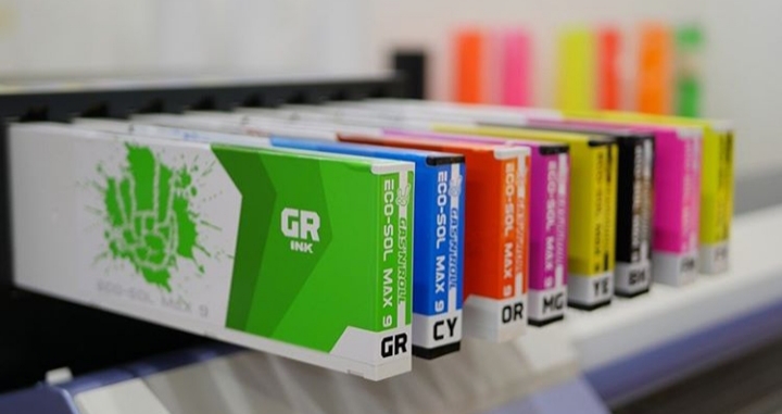

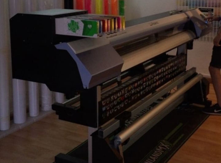

hello good someone knows how to install orange, green and red inks in a roland vs 540 i.
I have seen a configuration with fluorine inks.
I know that Roland took out the 640 640 with those inks. but I want to know if in vs 540 i can do the same option.
Attached image to see that it is true. I know of the existence of fluorine inks for this machine

The brand of inks is not "Gas N Roll". obviously the company made its labels with its brand of adhesives, so as not to reveal what inks it uses. I think it uses the same inks as the new Roland RF 640. There is an ink company that is called that manufactures fluorine inks for Roland vsi.

That’s funny. The to pictures in the bottom, that modification did the company I work for. We did it for a company in Sweden
Yes it can be done

The modification is quite simple and straightforward. We both Epson ink cartridges holder as a spare part. Then you connect out of ink sensor from the Epson cartridges holder and connect it in the Roland so it indicates when ink cartridges get empty. I don’t remember if it was necessary to flush ink line and head, but I think will not hurt for safety. Then you need to cut ink lines and connect to the Epson. Put dummy cartridges in the Roland so it think it’s have cartridges in there and to protect the needles if you want to reverse modification. You will need to have some ink line and luer fitting the ink line. Then you need to do a fill with the new ink and get a good nozzle test.
Then you need a Rip so you can control the ink channel and make profiles for your ink setup. We used onyx of natural reason. I will recommend you to buy your rip from a local dealer so you can get support and help in Spanish. If you can’t make your profiles by your self, maybe your local dealer can help you with that.
If you know any local company making modification to bulk system on Roland printer you maybe can get some assistance there if needed..
This is a ruff guide how we did it. It’s little hard to explain in words only and we don’t have any pictures of the modification it’s all in the head.
