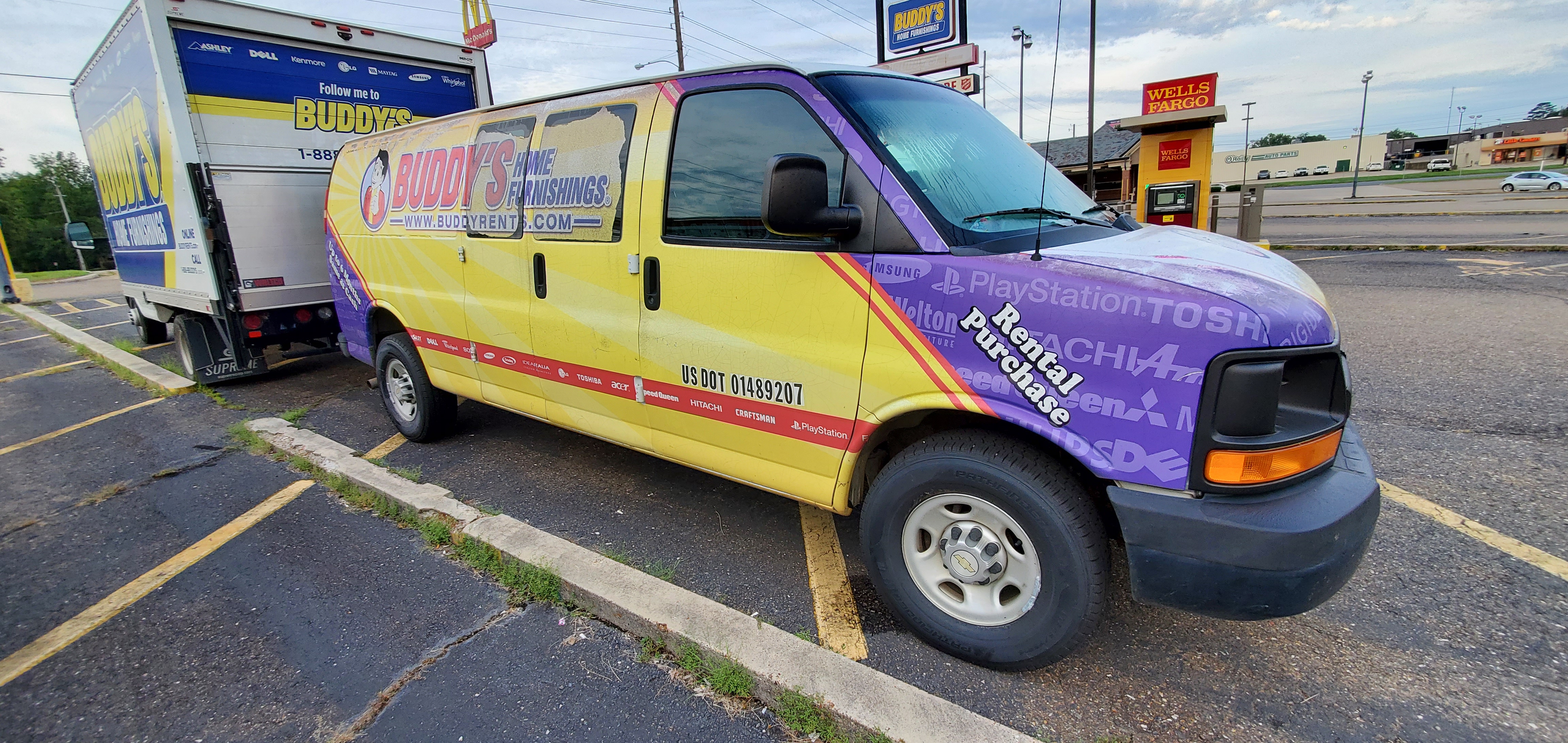

Since this post... I had a graphics company insist I wrap over a work van. The old wrap was cracked and peeling. I knocked off the flakes and wrapped right over it. I pass the van outside their store about once a week and three years later still looks good... even the rough spots on the wheel wells are holding up.
