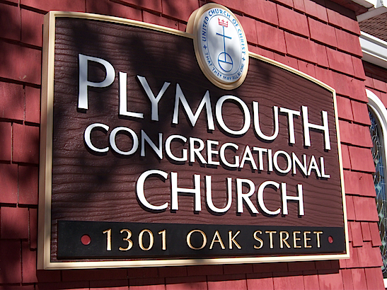

I don't know if maybe we're all overthinking this thing. We just put this up last week on cedar shake shingle and I cut a 1/2" thick piece of MDO about 6 inches smaller than the sign and mounted the PanelClip Z channels to it and the back of the sign in the shop. We first mounted the MDO panel on the building level and straight, spanning several rows of shingles, then hung our sign, secured it with one set screw hidden in the crotch of the letter A in Congregational and called it done.
Doing it this way, does give you a little standoff, but that seems like a small sacrifice to know that it is evenly perpendicular to the wall.
Some might question the use of the MDO instead of aluminum tubing, but frankly, a good primed and painted piece of outdoor plywood will certainly last as long as the sign does and the ease with which it went up can't be denied.

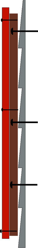

Like Moze said you can mount a nailer to the wall first that bridges the spaces, doesn't matter where you fasten it.
You can use aluminum tube, PT 2x4 or MDO. Then the sign gets attached to this.

@TimToad and Billct2. Yes, famous for over thinking, usually at 3 a.m. Anyway, thanks very much for the very good solutions, drawings, etc. which I'll definitely try next time out— though I will prime the heck out of that MDO.
