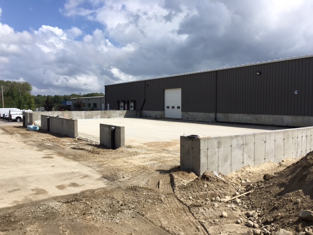

Hey all,
So we are adding a 6600 sq' area for vehicle installations. Our dpt currently shares space with the screen printing and embroidery divisions and we've outgrown that space. Our new area will have a total of 4 14' bay doors and one man door. It's basically am empty rectangle. I'd love to see some pics of others installation areas for inspiration if possible? Printers and laminators will be staying where they are so this is just for install. Thanks - Kevin.
Here is the new space, Steel starts tomorrow!!

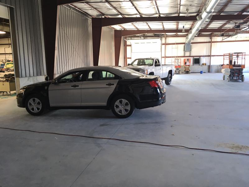

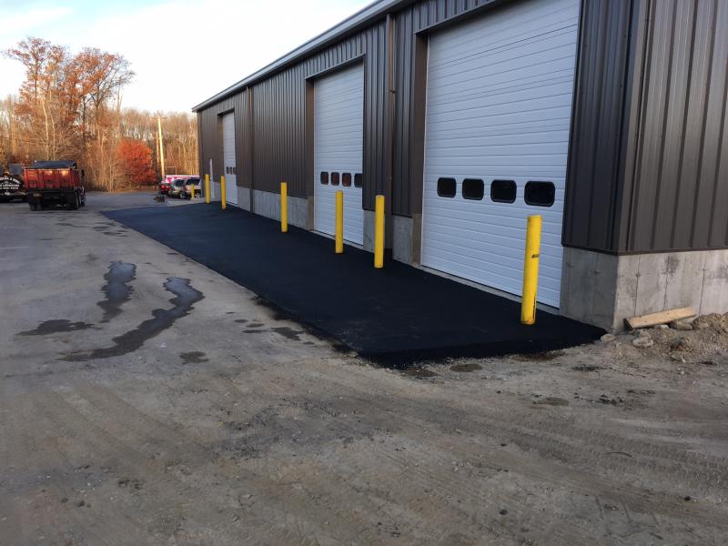

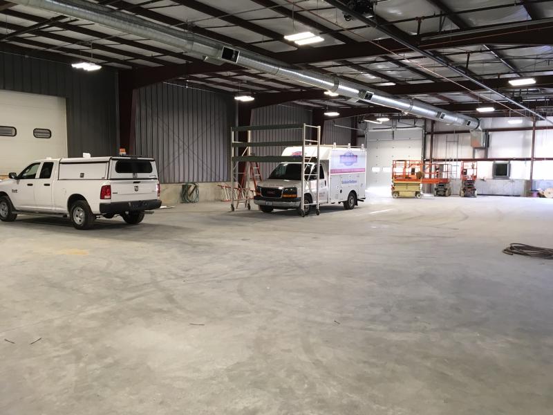

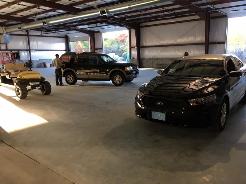

IMG_1577.jpg IMG_1542.jpg IMG_1565.jpg Getting closer, in the home stretch but not waiting for it to be done. Plenty of outlets,air drops and water, trench drain and all!

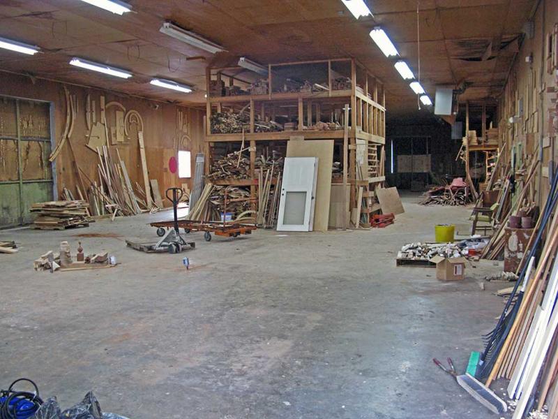

I'll have to take a current picture but this is what our install bay started out as about 4 years ago when we bought this property (it was an old millwork that had gone bankrupt). Truly incredible amounts of sawdust and scrap work everywhere. Just cleaning up took a couple of weeks. Then removed that structure right in the middle. Early on I changed all the old overhead 8' T12 fixtures to T5HO which helped a lot. Still a long ways to go though as I only have but so much time and budget. Exterior walls are all 6" and fully insulated as well as a full attic above with about a foot of insulation. Three 150,000 BTU forced air gas heaters hanging from the ceiling provide way more than enough heat. A future project is to wall in a section to create a separate smaller inside bay inside the main bay which will be cooled with a 3 ton AC unit I have in storage. To cool the entire bay all the time in the hot summer here would just be too expensive as there is often just one or two vehicles in there being worked on. Also in the works is to eventually paint all the walls and ceiling white in addition to adding more lighting on the side walls (have already added some) to further brighten things up. At 129' x 43' its overall about 5500 sf of install bay. I've had four 35' city buses inside at once along with a couple of smaller vehicles. Right now there is a 40' city bus and two box ambulances in there with room for more. :) Looking at this old photo now just looks bizarre to me....
