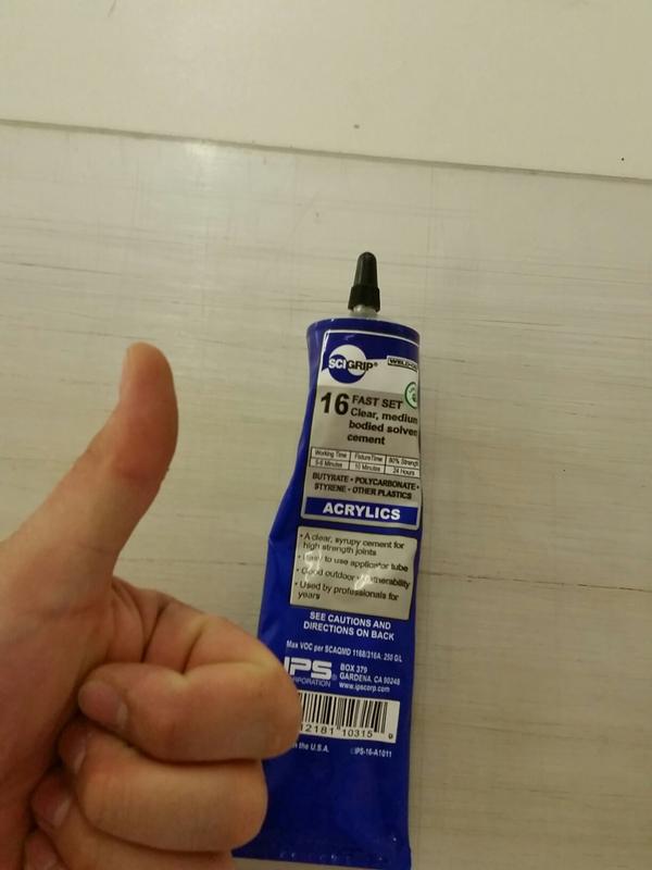

Don't need instructions lol. Right on the tube it says ACRYLICS lol
attachment.php
