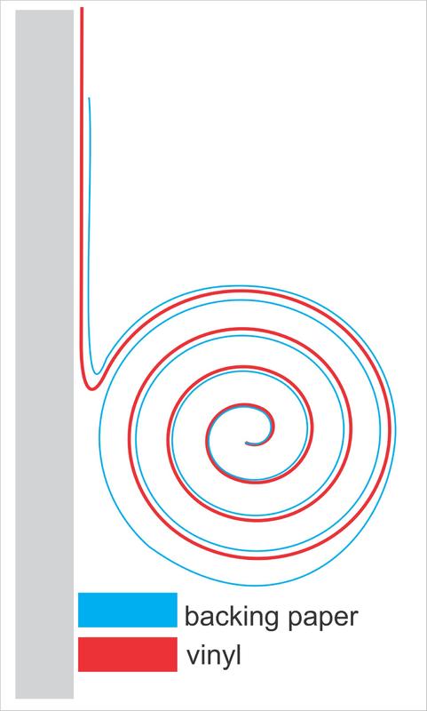

i found out that "reverse roll" method would be most suitable for me... but i dont know excaly how it works...
does anyone use this method?

basically impossible to type out how to do it, you tube window film California Rolling Film or back rolling window film subjects, should get something. If you have a paper linear or tight synthetic you may need to have someone pull it for you or help flip.....Keeping dust out is always a problem its more of the environment and cleaning the glass

i did some sketch... im i thinking right?
