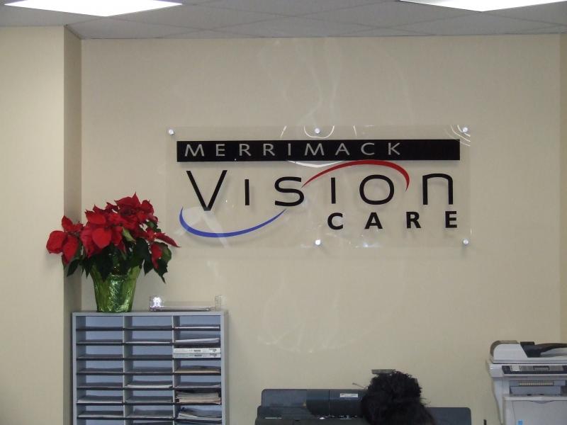

dj_elite
I have used stand offs. They look good too

I don't want to do stand offs as it is a Jiu-Jitsu school. So it may get some bump and grind. Projecting off the wall will only weaken it.
