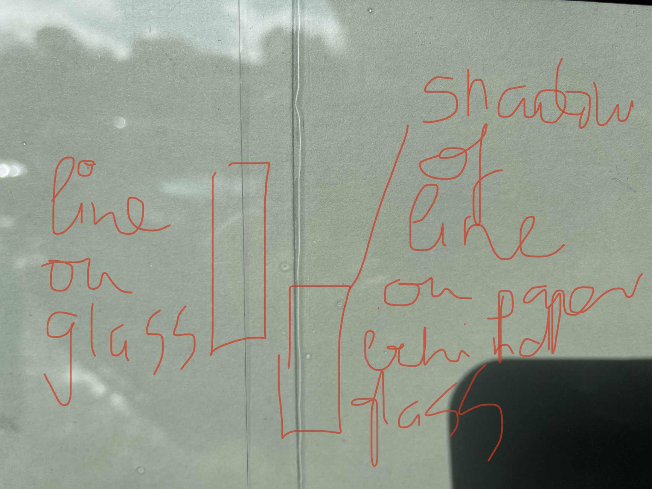

Having done lots of butt joins on wall vinyls, we though this should not be a problem. Did a trial in our studio window and we are not happy with the result. There is a 1/16" fine line where we cut the butt join. Please see photo attached showing the line on the glass and also the shadow of it on a sheet of paper behind the glass (sorry for messy writing, done on my phone). I can't make it disappear. I have left it to dry for a day and pressed it down again. I have tried to heat it gently with a heatgun, it does not go away.
It seems the me, that because of the thickness of the film, it does not lay completly flat once cut, so it's just a tiny bit too long for the space.
The film is 3M AG4.
Is there someone around who had experience with this? Could you please help? What would you do, how would you join the film?

After detailed cleaning of the window, we reverse roll the film, separate the top 5”, while spraying it with baby shampoo + water solution. Spray the entire window except the top few inches, where the film is wet already. Apply the film to the window, remove backing, spray the film and secure it at the top, then squeegee it, middle down first, then horizontal squeegee stripes on the two sides, stopping about two inches before the frame. Do release cuts at the corners, cut the extra film, squeegee it till the frame. Apply the second sheet of film and overlap it it vertically about one inch. Once it is secured/ squeegeed to the glass the same way as the first sheet, cut a vertical line through the two layers right down the middle of the overlap. Remove little piece from the top, then carefully lift the corner of the first sheet at the top and take out the small piece from below. Spray the middle section and squeegee down the join with vertical strokes.
When we use this method with wallpaper or a thin film on glass the joint is seemless. But with the thicker anti graffiti film we are having trouble. As if the top layer is just a touch longer and cannot lay perfectly flat next to the first sheet. It is stuck down, but there is a shadow line showing / or some air? And we cannot get rid of it.
This is on a test piece on our studio window. The project we will do has many individual windows sized: 8’high and 7’wide. It is not a large seemless glass area, and there are no silicone joins.
Don’t want to apply it on the client’s window until we can do a better job! I’m hoping you migh be able to offer some advice. Thanks so much!

Thanks for your suggestions, we will go ahead with a horizontal join and just butt joining factory edges of the panels instead of double cutting. The join will be at the level where the safety strip is on the inside. So not invisible, but still hidden a bit.
