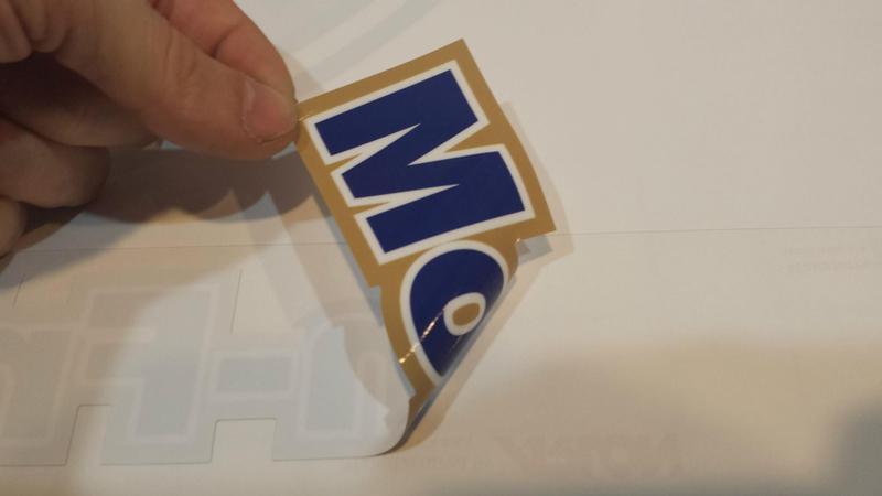

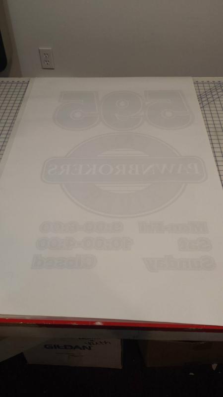

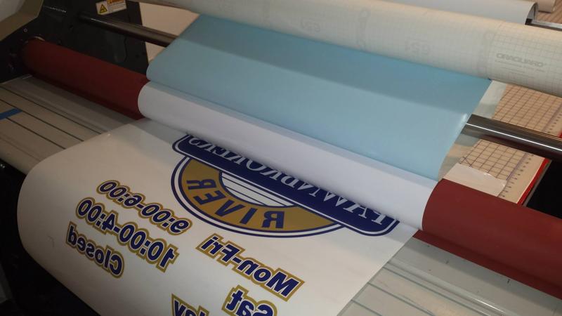

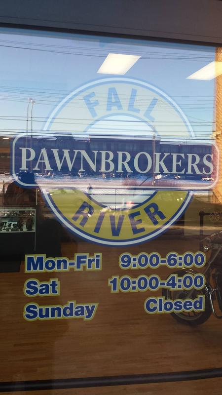

Print in reverse on clear vinyl. Laminate the print with white vinyl. Apply vinyl. Done.

How do you manage/clear your registration points for contour cutting after laminate the clear vinyl with white?
I put masking tape over the registration marks before laminating with white. Then cut around the masking tape through the white vinyl only and expose the registration marks.
