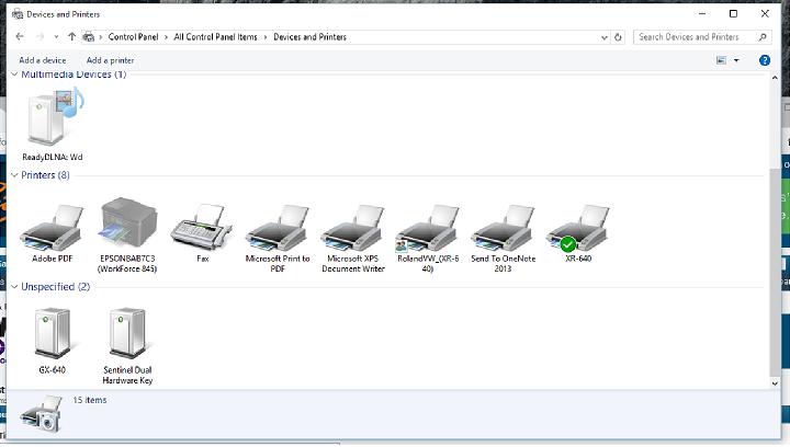

Hi everyone,
So we upgraded our computer, and everything is running perfectly, except for the fact that I cannot remember how I set up my Camm-1 Pro GX-640 vinyl cutter as a printer in Windows, instead of an unspecified printer. I have tried uninstalling the device and re-installing with the downloaded driver information from the Roland website, but it still comes up as an unspecified device instead of a printer. I know to set it up in Versaworks and have them both run from there, it needs to be specified as a printer, I just cannot remember how to get to that point.

I have the drivers, that's not the problem. When the drivers are installed, it shows on my machine as being an unspecified device. What I need is it to show as an actual printer, and I know there is a way to do it, I just cannot remember...

It is indeed Windows 10, and it keeps telling me that it cannot find the file specified, after following the instructions. It's weird though, I was able to set up our XR-640 with no issues...
It's not weird at all. RIP-based large-format printers do not need Windows-based drivers, because they use the driver in the RIP. The Roland cutter needs a driver to be seen by the OS.

Got it fixed and figured out. Roland called me back today and was able to get it going in Versaworks. Everyone's suggestions were 100% on point here, I apparently just had the wrong driver. I downloaded it from the Roland Support website, so not sure how I got the wrong one.
