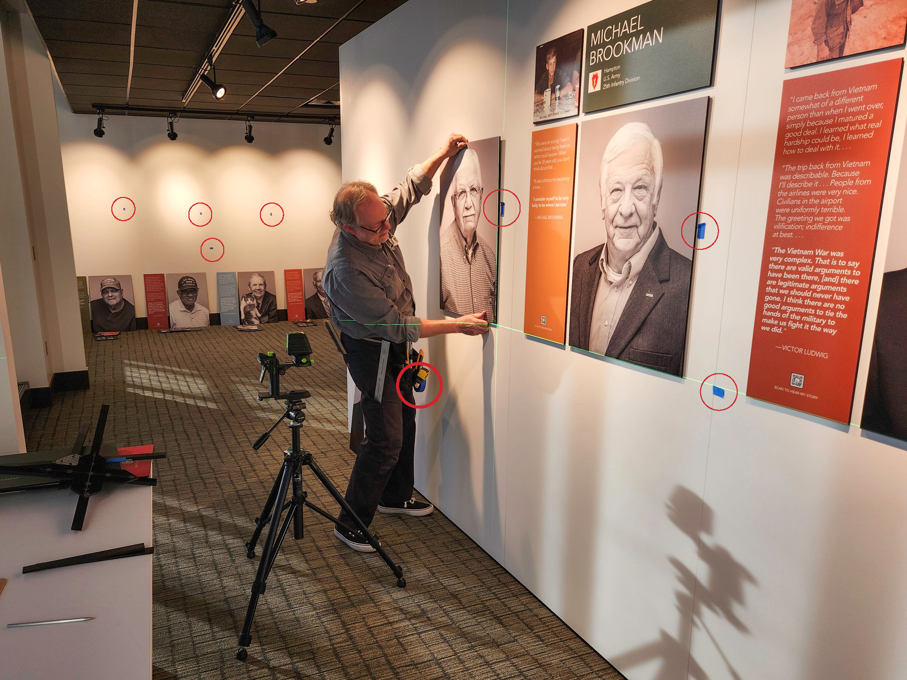

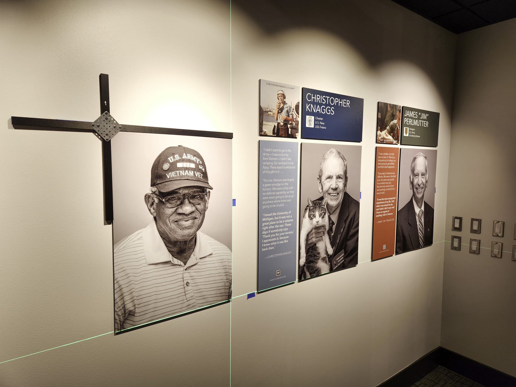

Attached are a couple of photos of an exhibit with 200 evenly-spaced panels. These were all prints on vinyl mounted to 1/4" PVC, and put on the wall with 16-lb Command Strips. The second photo shows the laser being used to line up a panel with the previous panel, and the jig to space the smaller panels. The jig is made from scraps of PVC and a mending plate. The third photo shows the laser level (this inexpensive Amazon model works fine for me) mounted with a fine-tuning bracket on a sturdy tripod. I also usually double-check my work with a bubble level.

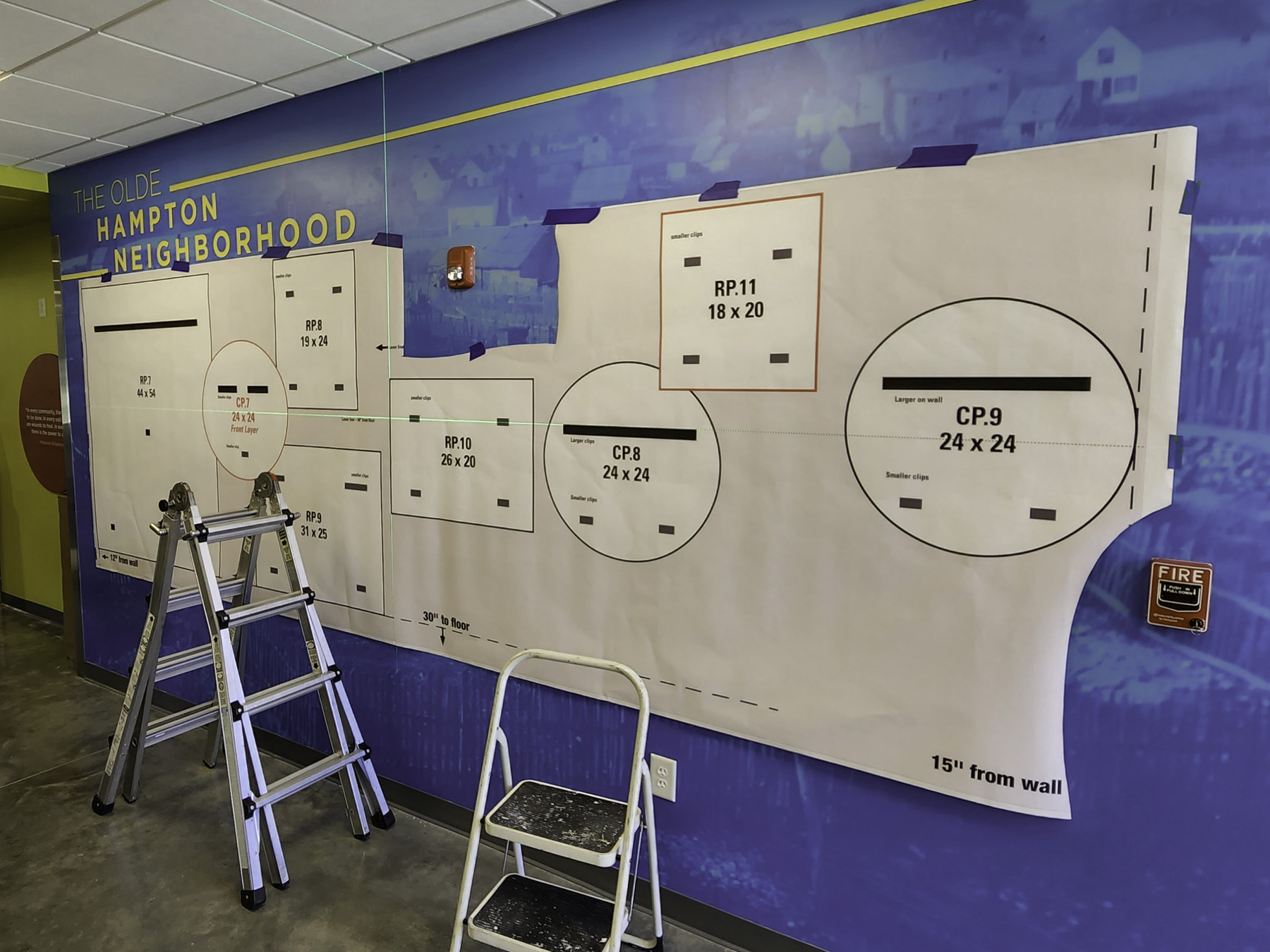

Honestly, a laser level is real nice for something like this, but if you want it done quickly in the field, just buy a roll of cheap low tack paintmask vinyl/paper and precut/plot your mounting holes, then drill and get it done.
A template is extremely helpful if the spacing is random and/or you're hanging with cleats and need precise positioning for the wall cleats.
