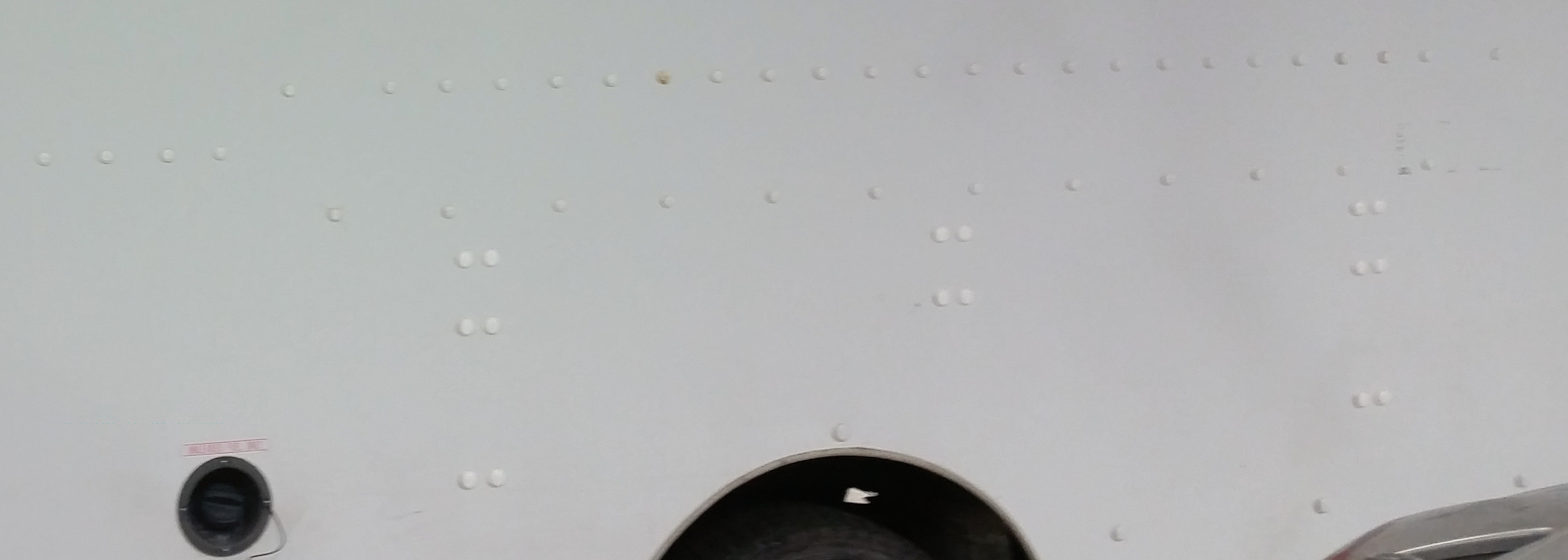

A little help would be greatly appreciated on instructions on installing over big plastic rivets.
If someone could point me in the right direction, or give me some insight on installation or give me the correct wording so I can search it.

here is a photo.

I would follow the application as in this video:
You will have to make a few tweaks for the type of rivet but the idea is fairly similar.

Wrap is not meant to adhere to those plastic rivets so make sure you are upfront with your client about expectations. We always warn that they may not stay long term and do not warrantee them. Anyway, we primer them around the edge. We wrap it and heat it in. After it's in, we cut around it so if it does fail, the entire piece does not tent.
