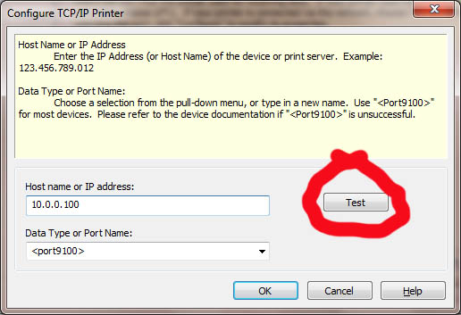

The computer that has the RIP installed must be on the same LAN, in the same IP Range as the printers. The simplest way to check this in Onyx is to use the 'test' button on the configure printer screen - see attached.
If the test button fails, it means that the printer and RIP cannot communicate with each other for some reason. It could be for one of many reasons, including incompatible Anti-Virus software, wrong address defined, firewall, physical cabling, bad port, etc.
