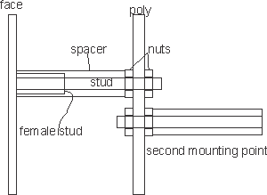

Weld female studs to the back of the face, slip on spacer, bolt down polycarbonate against the spacer, and have an extra mounting hole to bolt onto the acrylic and go into the wall. To jump between sections, I wouldn't worry with conduit or anything if it's all secondary wiring.
Pulling primary to a no access wall is always the tricky part for us.
Another option that's a bit less of a headache but quite a bit pricier is detachable studs that gemini sells:
