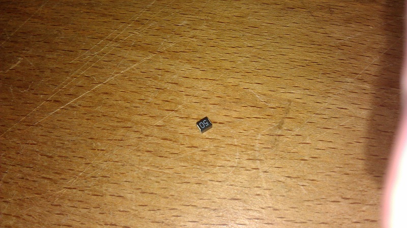

There are fuses on the mainboard for the heads, at this machines they are soldered. At the attached picture you could see a Mutoh fuse of this kind, but because its one for a rockhopper II it could be that the ones for the RH I differs. They are around 2-3mm long. You should check the surrounding of the connectors for the printer cables.
But be careful, regularly when the fuses are blown there are a reason for it. If manipulating with the printers electronic (with print head cables too), don't only switch it off ... pull out the power plug and switch it on and off again with no power connected to be save. When re-assemble check that you connect the cables correctly.

but the machines are rockhopper 2, both take epson DX4s, adaptors are either solvent or water compatable, maybe you can tell me can I attach the cables from the other head that is printing to test the fuse issue?
FrankW
You can try to do that. If you need to reach the head driver board or mainboard be shure to use an electric screwdriver, because there are a lot of screws to remove ;) .
