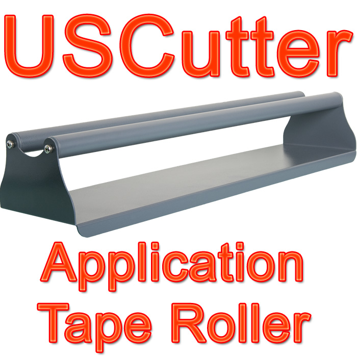

i still like rapid tac II but do more and more things dry since getting a couple of these. taping it good makes all the difference in the world :thumb:
