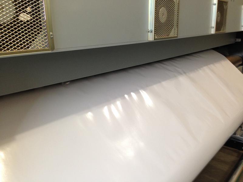

As long as the material is running through the machine, no issue. Let it sit in the printer for more than a few minutes before printing and you'll get buckling. You need to advance until you get material fresh off the roll. Definitely not a material you leave sit in the machine if only printing jobs here and there. My solution has been to print full rolls if possible, or cut the material at the back of the machine when done printing and roll it back up. Saves a couple feet. I know it's pretty economical media, but over the course of a roll, it adds up.

Donny, I run this on a Latex and we are not experiencing any buckling issues. We always leave the material loaded and leave it at the pinch rollers until use (then we feed it to the cutter line when ready to print).

I'm running on Seiko M64 and W64 printers. I would imagine the heat and tension of the over/under roll webbing is helping on the latex? I didn't have a chance to run any through my L26500 before I sold it, so can't tell you if I would have the same results on that machine.
The M and W have a straight in path from the back of the roll. The pic I included shows the media after sitting in the machine for about 2 hours this morning after a quick print. I would usually cut it and re-roll, but got side tracked. This doesn't happen with any other film I have in house. I have Oracal 3651 loaded in the W64 that sat overnight and looks perfectly flat. All stock acclimated, temp and humidity in the shop is pretty consistent at 72 +or- 3 and 35 +or- 5, year round. Heat settings on both machines are 42 Pre 40 Print and 50 Post.

I have the Seiko W64S too and I get the same buckling....First container that I ordered from had the clear backing, no buckling, this batch does. I thought it was my machine doing it.

Good media, prints well, but the backer is constantly causing issues (head strikes) even on high position with our Mutoh Valuejets. As was said, if you can start it and let it print it's fine, leave it sit for a few minutes and it will start to warp/buckle and then we have to advance it about 3-4 feet to where the backer hasn't absorbed extra moisture from humidity in the air. Really is a pain and I hate wasting material, but for the price nothing else can touch it even with wasting about 10-15% of the roll when you're running batches of small jobs.
*BTW - we do have our print room air conditioned and it still happens...I wouldn't dare try to run this in a non-AC environment with high humidity. Although I will say we had far fewer problems over winter when the air was dryer/cooler. If they could get the backer issue resolved with a slightly better material this stuff would be perfect!
