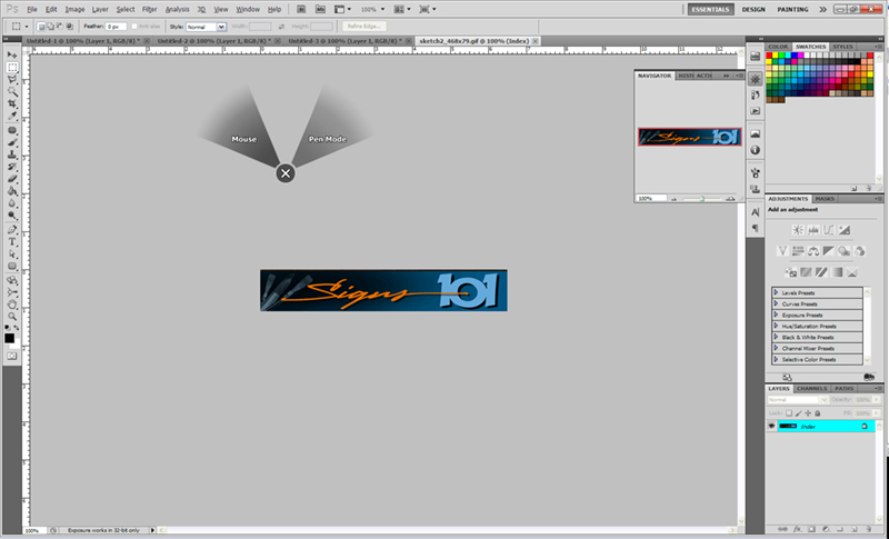

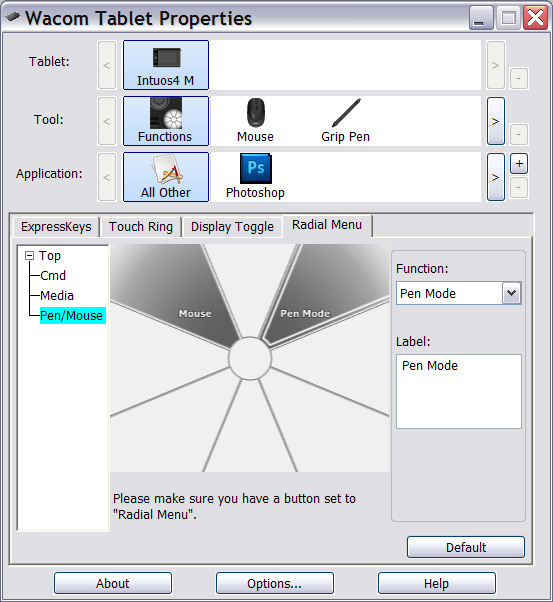

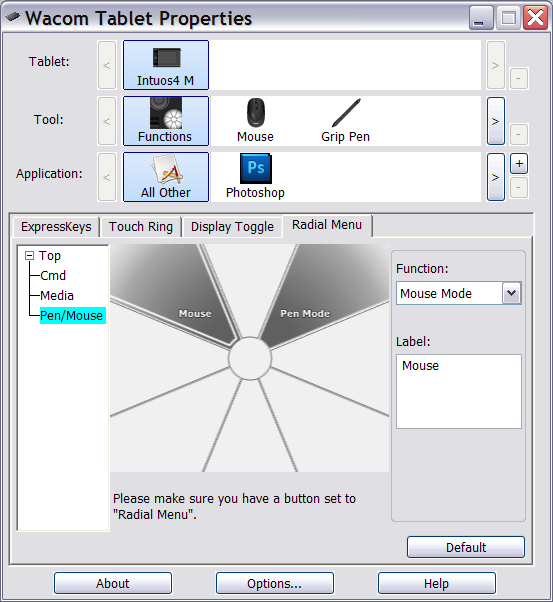

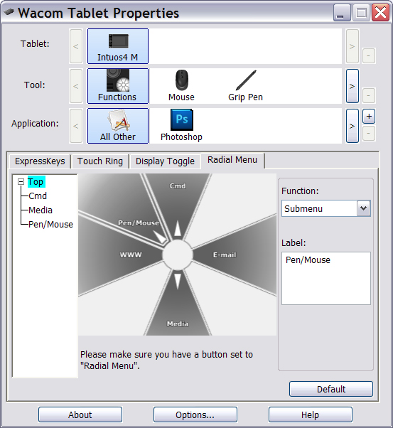

What I'm talking about is using mouse mode when you are using the pen on the tablet. Mouse mode is the standard speed and acceleration approach to moving a cursor on your screen. Pen mode is mapped to the screen requiring the pen to be moved to exactly where you want the screen cursor to be. What I'm saying is that you can set the pen to act in either fashion. For normal operation, I prefer mouse mode and for graphics work I prefer pen mode. But I am using the pen in both cases. I have the switching set up in the radial menu for easy switching back and forth.
As far as the Intuos mouse as a hardware device ... I hate it. What I hate about it is the extra force required to move it as opposed to the MS Optical mouse. So at a certain point I put it in the drawer and quit using it. But a good amount of the time I just use the pen as my mouse in mouse mode instead of reaching for the MS mouse.
Hope I'm making myself clear. The terminology can be confusing. The attached screen shots show the setup for the mode switch in the radial menu section of the driver and how it appears when the express key for it is pressed.
