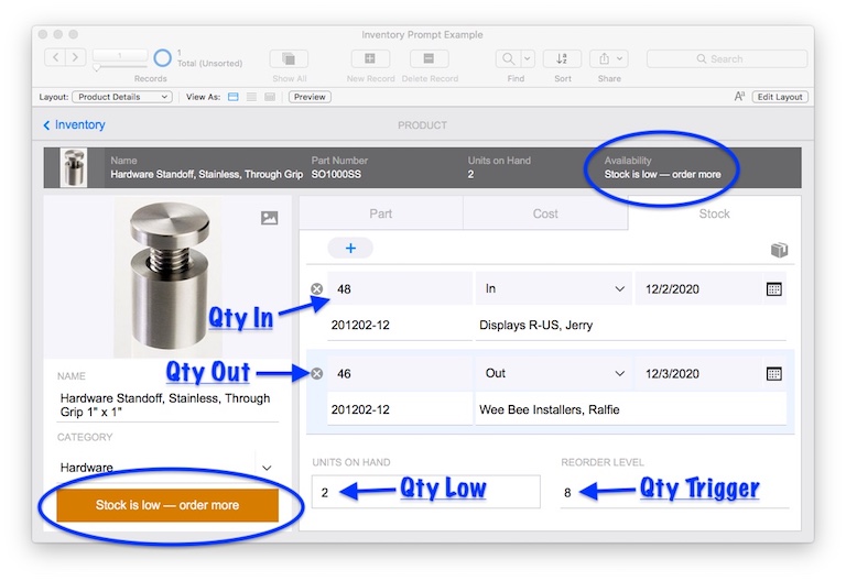

We just want to streamline the process and have order reminders when getting low on certain types of vinyl.
See the attached image of an example of simple inventory data points and the prompt "Stock is low – order more." The file is free from Claris FileMaker to use with their database authoring software. Most shops modify and extend this file for their own systems to make its use much more automated.
