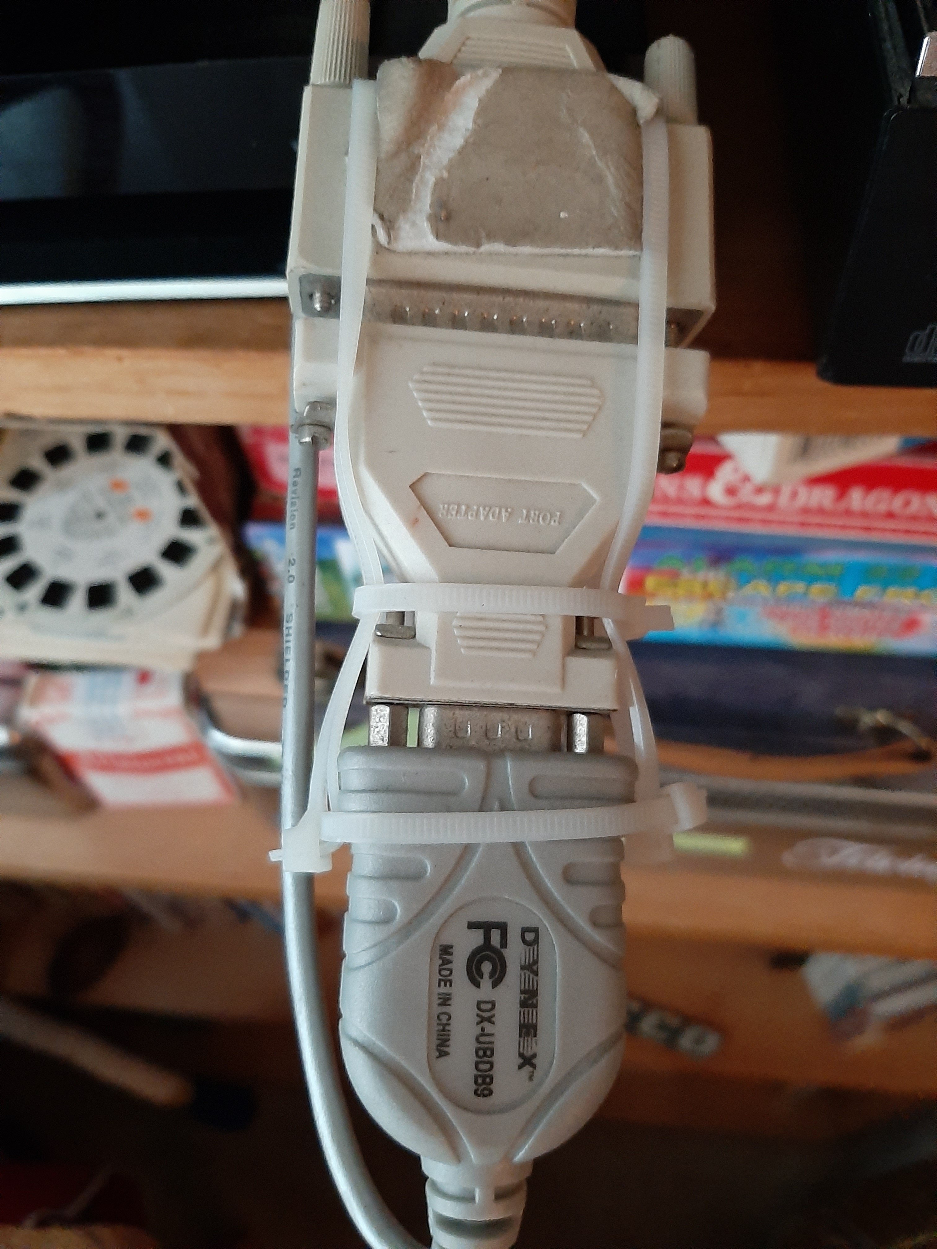

I have a studio 7. I used flexisign pro 8 on an old levano think pad running xp. I have a usb to 9pin adapter to a 25 pin to serial adapter? I cant remember exactly but heres a picture.

If no current software has a driver for it, could always see about setting up a RAW HPGL "printer" within Windows. If I recall correctly, it should support HPGL (I suggest RAW as I'm used to the device being able to parse what it needs and leave the rest, that way I won't I don't have to worry about something not being sent properly).
On the platform I am on now, this setup is relatively trivial, I don't know how it is on Windows as my need for it didn't happen until after I was off Windows, but Windows does have (if I recall correctly) HPGL support built in from XP on.
It's just another option if there is no straight forward software option as for some it may be more technical then they want to deal with.
