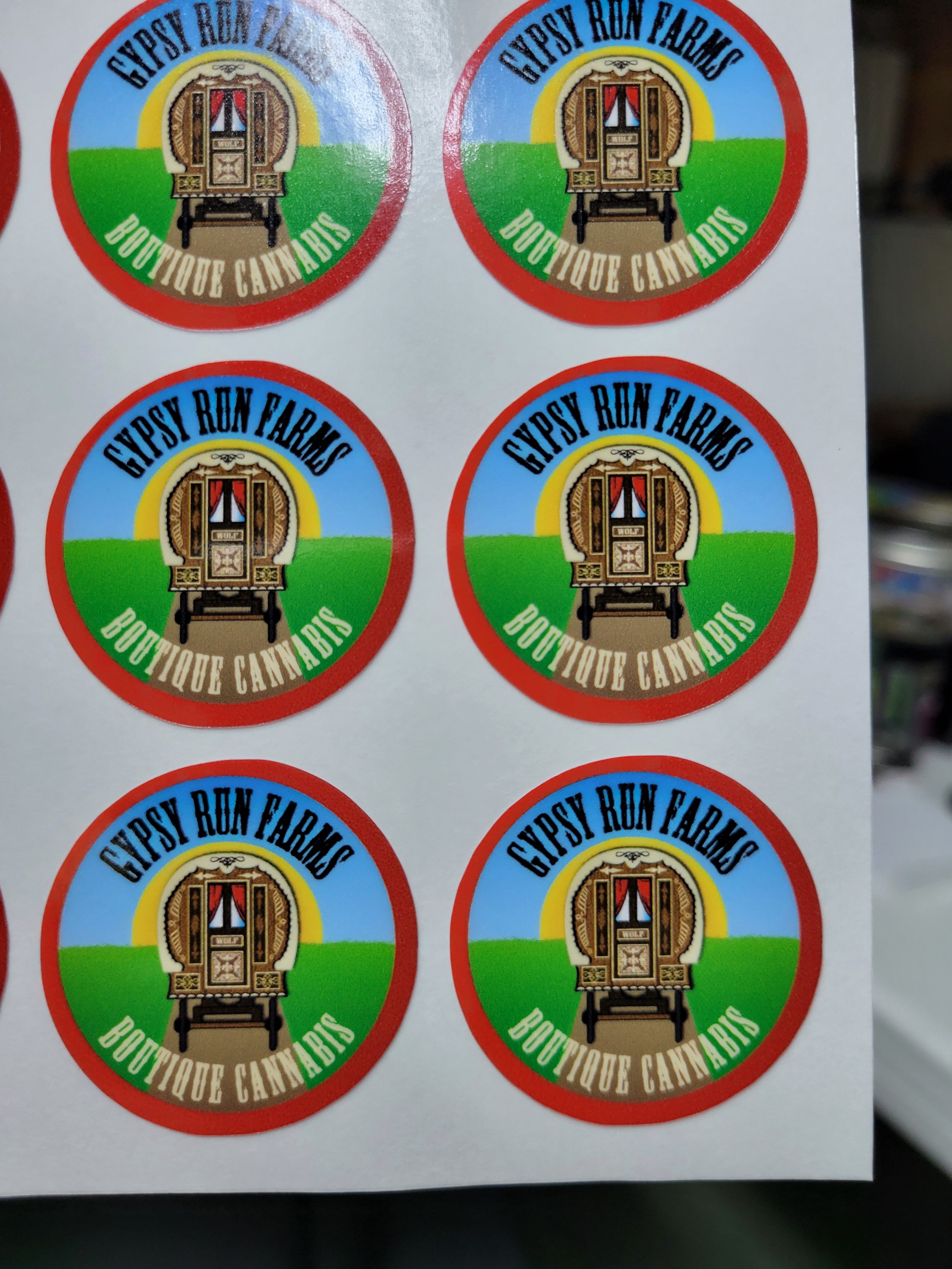

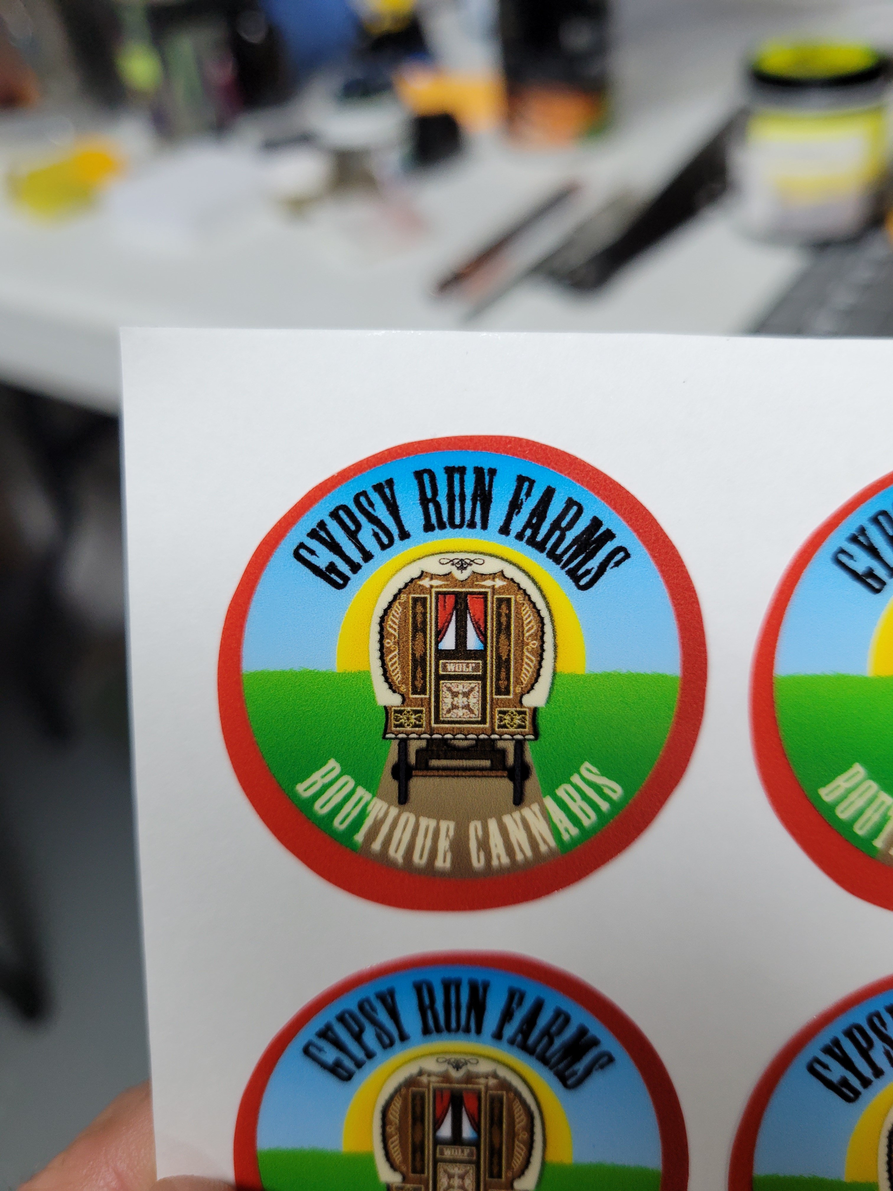

Came back after a couple of days laminated a few sheets and started cutting with the barcode like I normally do and my cutting was way off. Seemed to be about 1/16" off in some places, near the center of the sheet. The outer two edges were fine. I noticed as the moved to the cuts near the middle of the sheet they became more off. This happened to a couple sheets, and it was spitting out the sheets when it went to look for the next opos mark or it would spit them out during loading. I did a factory reset, calibrated my opos and tried another cut and got the same result, actually it was even worse. One sheet came out fine, then the next would be way off.
Never had this happen before so I'm not really sure whats going on. If something went haywire in my cutter or there is something else going on.
I attached a couple photos of one 8.38" sheet the difference between the top and the bottom of it and how off the cuts are.

I assume those aren't supposed to be perfect circles. In the second image, it's most noticeable on the red border above the word Gypsy?
Are you imposing the stickers yourself or letting the RIP do it? I always triple check my files if I have done the imposing myself, just to make sure I didn't bump the registration between art and cut line.
I feel your pain, these kind of things can really throw a wrench in your day. Factory reset won't probably ever help, but you should always calibrate/set the OPOS mark more than a few times.

They are supposed to be circles. It happened on another file as well. I impose my sheets in Illustrator and then step them out in Onyx.
Occasionally I've had some cuts that were off but not like this.
The odd thing is the on the outer edges of the 54" sheet the cuts are good. Even borders all around as it moves towards the center of the sheet it goes off like this. It's very bizzare.

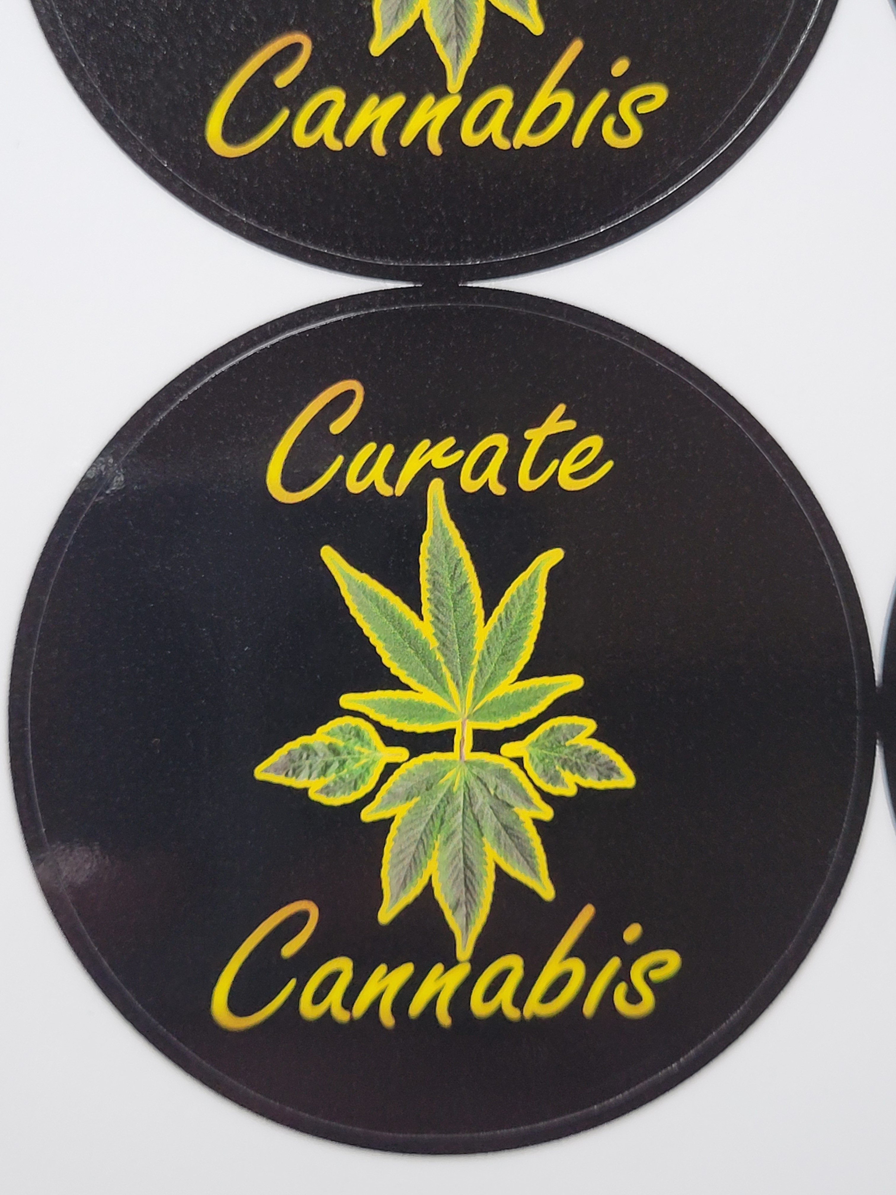

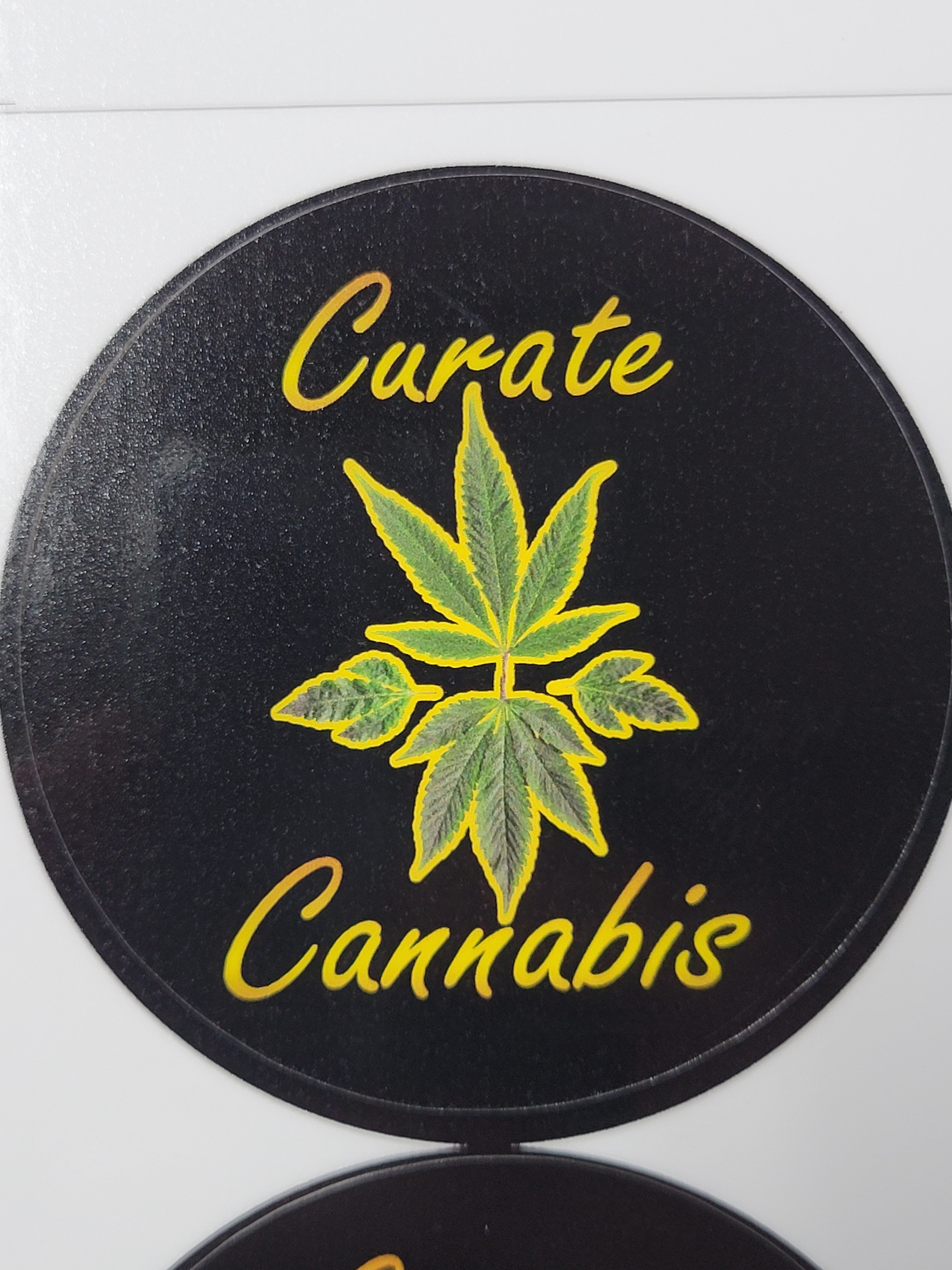

The issue went away for a little bit and now it's back to doing the same thing again. Near the origin the cuts are good but as it moves up the sheet the cuts get way off as the photos show. I just have no idea what is causing this.
It's very strange, it'll work fine for a bit then it'll start cutting everything way off. I re-calibrated opos, slowed it down to 300mm/s (I never run it above 400mm/s with laminated material). I feel like it has something to do with the mark or the sensor...I just can't seem to figure out why it's so erratic. Before this I cut about 1k die cut stickers without any issues at all, so I'm really scratching my head on this.
Note: I've also tried changing the registration mark size slightly, putting more of them on the sheet thinking I'd get better alignment.
