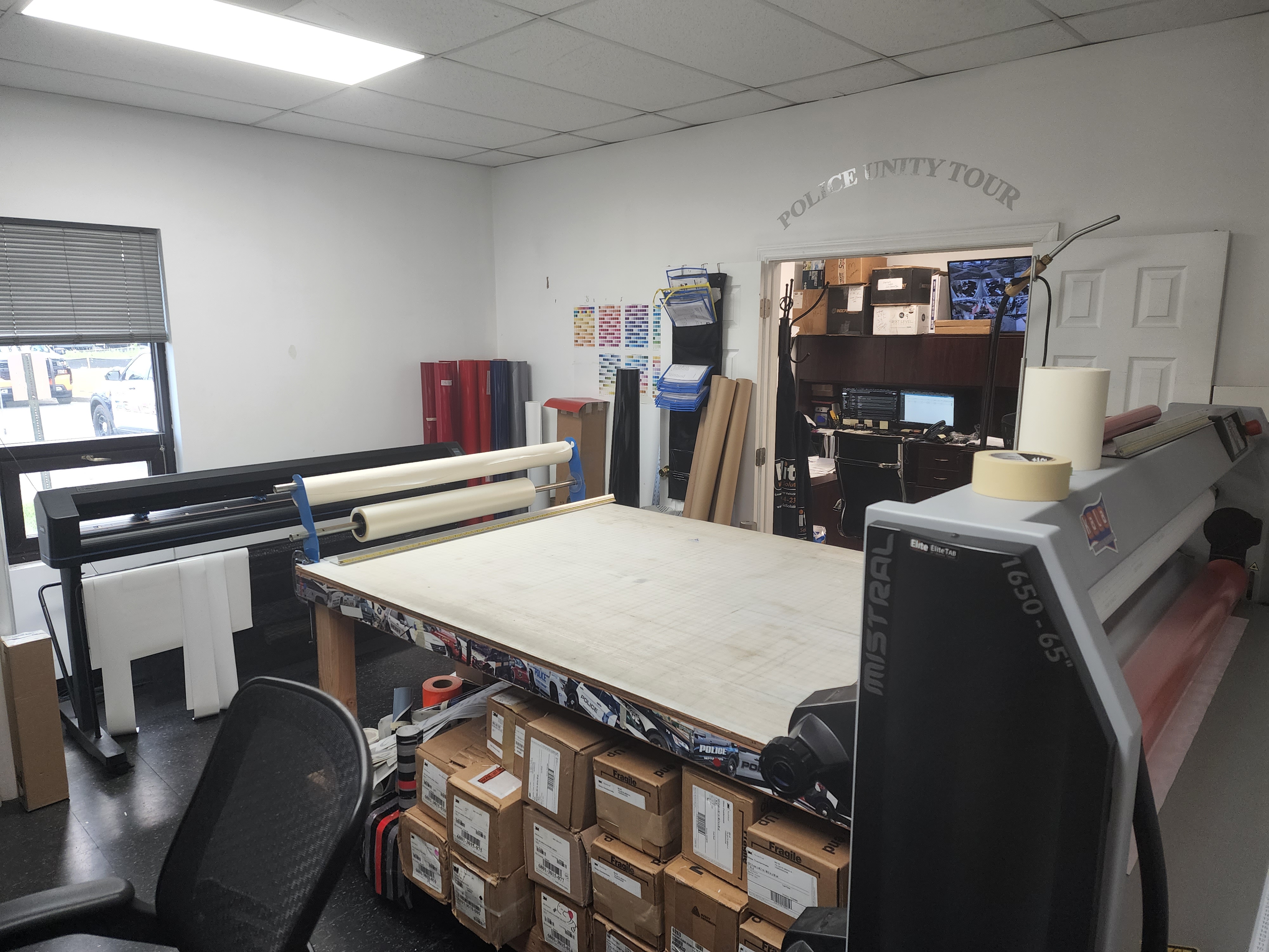

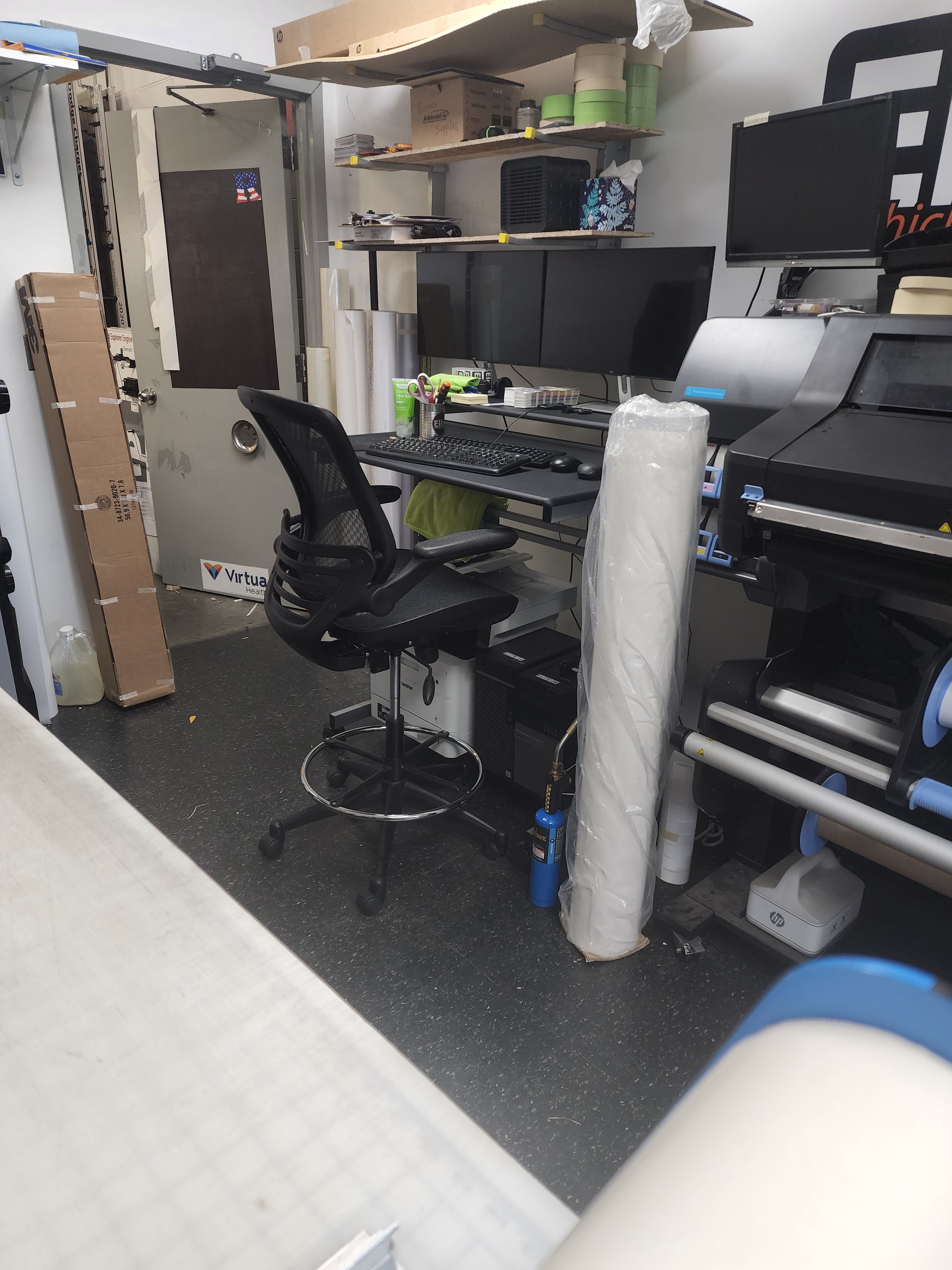

My daily gig is working in a 12'x14' room, housing a HP 560 Latex, a Summa S-One D160, and a Mystic 1650 heat-assisted laminator. In the middle of the room and behind the laminator, is a 50"x78" table on locking casters. Tight? HELL YES!!! Printing with certain vinyls can make the place smell, where I leave the area out into garage bays. I regularly print on 3M IJ680CR here and the smell isn't that bad. Now the heat with the 230v HP printer is another thing. It can make the AC feel as if it isn't on at all.
I run two computers with a KVM switch so the design machine is not messing while RIP/printing with the 2nd box. Both are on UPS backup batteries, which are needed as the electricity cuts out a few times a year. It allows me to print for 5 minutes, so hopefully it can finish. The design computer lasts about 45 minutes before getting near 50%.
If the company wasn't moving within the next year, I wouldn't remain working in such a confined space. As it is, I have 3 eco-solvent printers, a 72" cutter and two laminators, and a 5'x11' rolling table at home inside a two-car garage. The smell isn't as bad as I use hepa filters which cut the airborn particulates dratically. The challenge at my day gig isn't so bad, knowing I won't be producing anything larger than the side of a pickup.

I love your little set up! We just closed our 10,000 sf facility after 50 years and moved into our 1500 sf apartment below our house. Its a similar set up and super efficient. However, the Mimaki eco-solvent really needs to be vented outside. It gives me a huge headache from the fumes. What kind of desk/workstation is that? I need something like it.

Well, this is inspiring -- although you DO have the luxury of a window! But you've also packed the hell out of that room, and it makes me feel better about going forward with the plan... as long as the building power is up to snuff, or they're OK with getting it there... Thanks for the great example of this situation working out so well.
