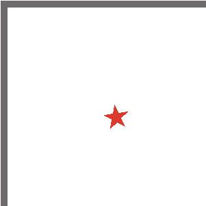

SignSmith
Graphtec
Does your registration mark look like this one? When loaded, should be lower right hand corner. Try placing tip of blade where I drew the star on the attached image. Speed can sometimes be a problem if your pinch rollers are dirty, cleaning them with alcohol helps most of the time.
I was setting my origin point in the wrong place, and when I learned to set it here, I've not had a single problem since.
May not be your problem at all, but its worth a shot!
Good Luck.
