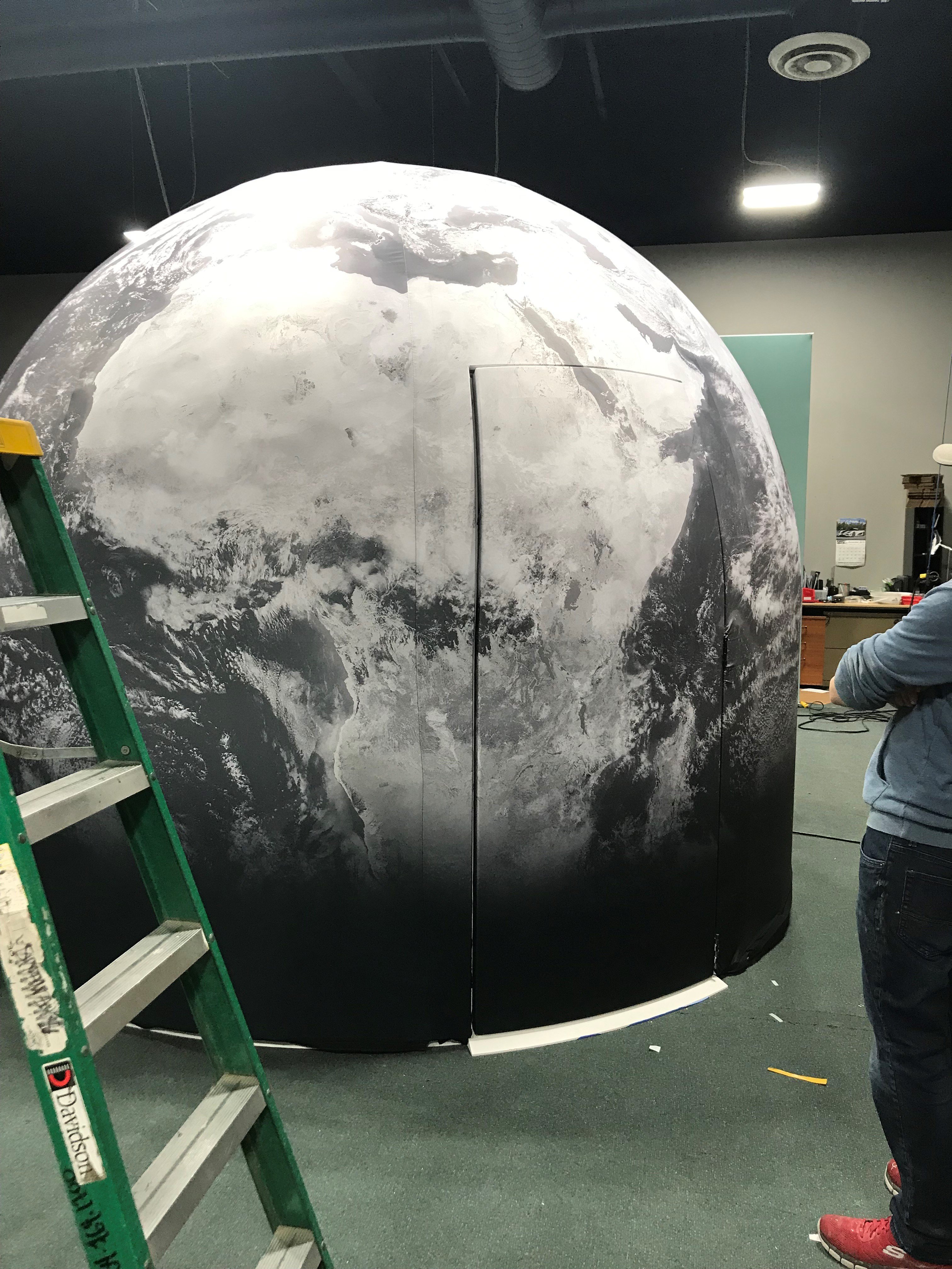

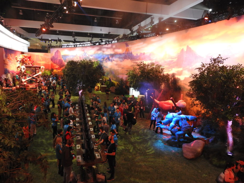

Andy_warp

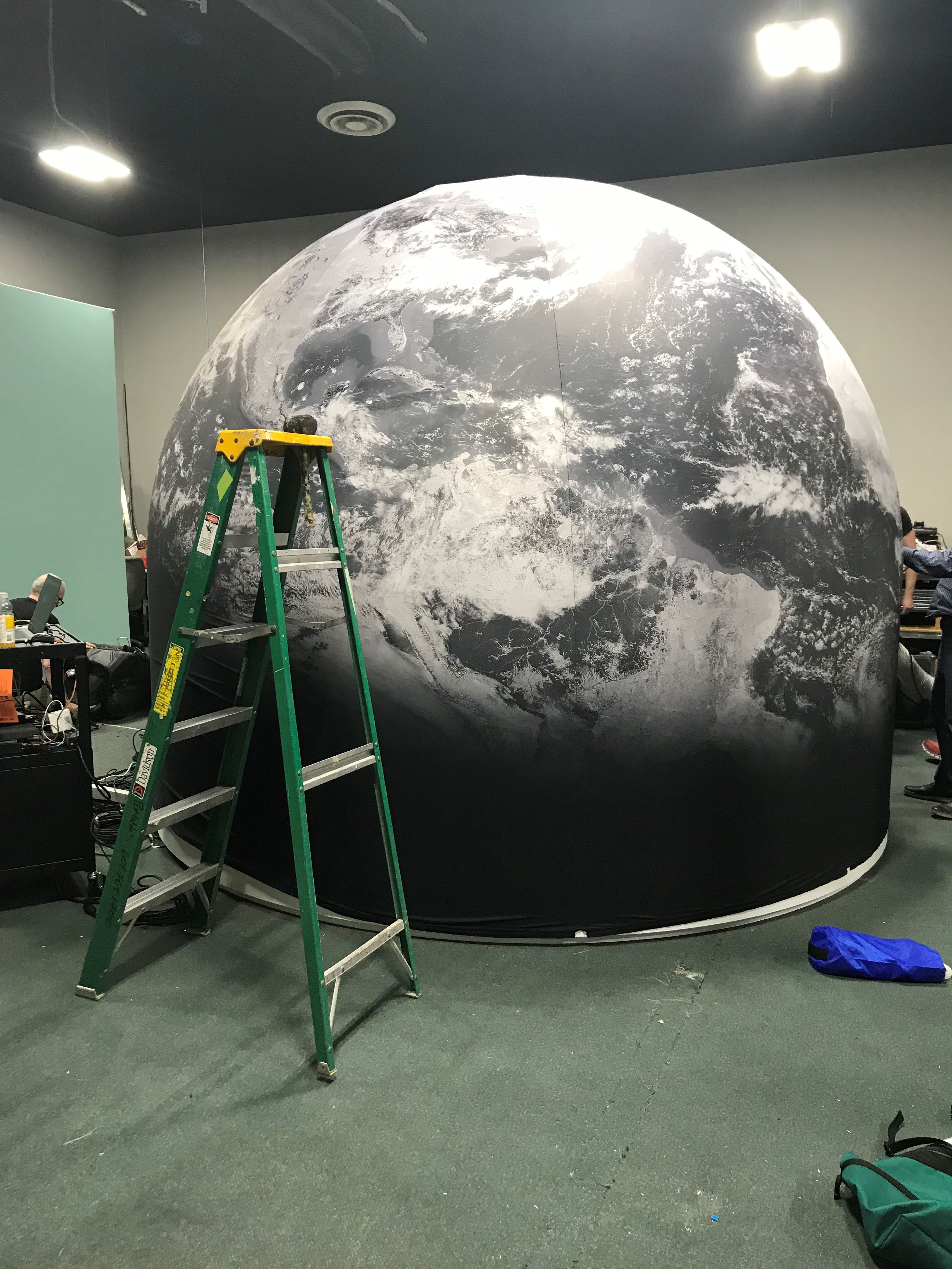

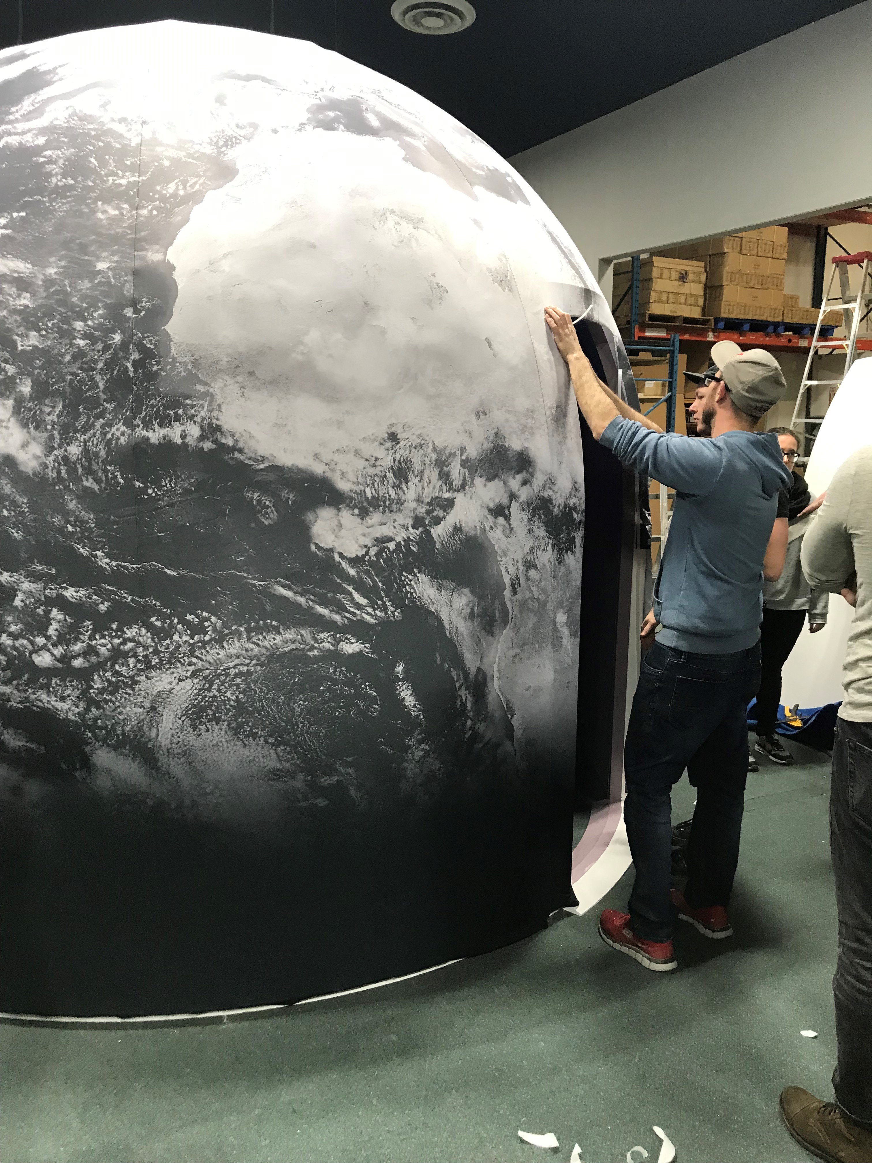

Holy smokes dude, that sounds like a nightmare! I guess if production messes up a middle panel, you have little to no hope of reprinting and have it look even close to correct, huh?
Yeah dude! We have to straight up stop the presses until it can be reprinted, then production can commence in order. The transfer paper is cheap compared to the fabric, so if we catch it before the transfer it’s usually good.
It happened to me on this 200’ back wall and some of the image seams were like 6” off! There was an awesome av and lighting team, and the art was painterly. The overall size of it also made it less noticeable, but it was in between 2 or 3 panels on either side! Frightening stuff! Never again!
