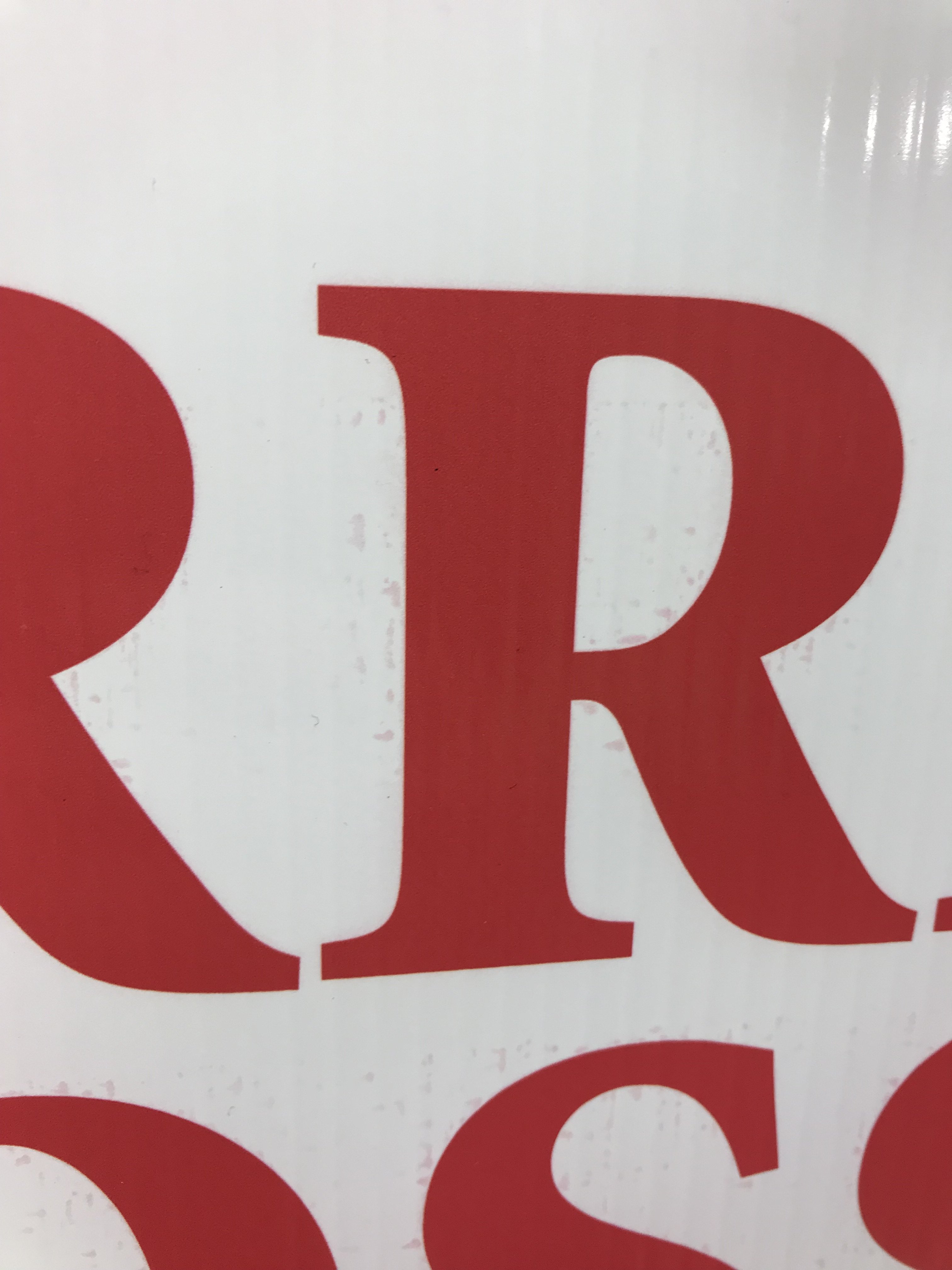

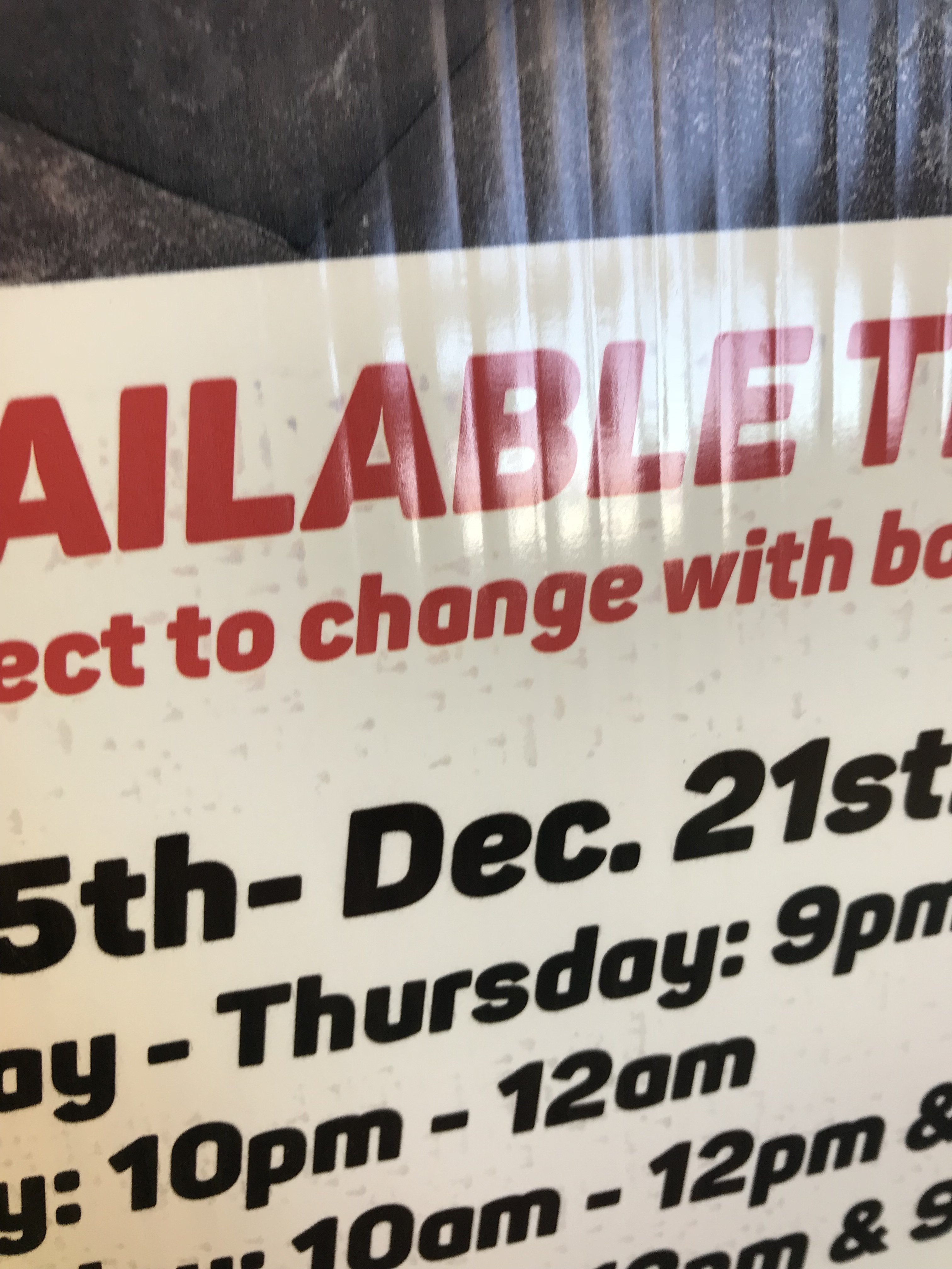

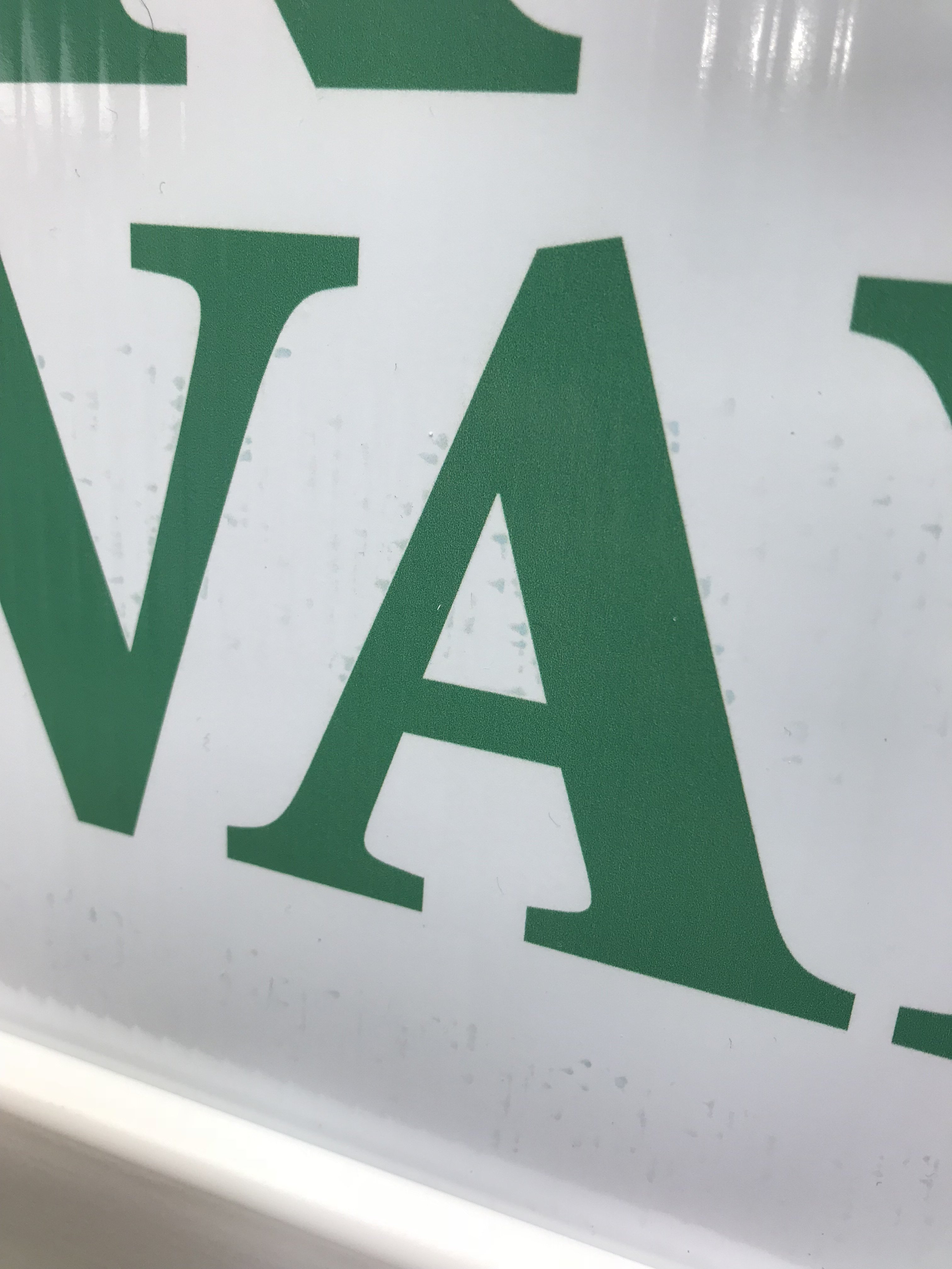

I've printed a lot of things over the years, but haven't seen this issue before. Check out the "droplet artifacts" in the pictures (all part of the same print). 18x24 yard sign, printed on IJ-35. The entire job was for 40 signs with about 30 masters, and there were a lot of busy graphics, but I'm certain that at least 95% of the prints came out perfectly (if not all of them). Anything less would have been too hard to overlook.
- The red and green text is about 1.25" tall
What I know so far:
Customer emailed me these photos today. They haven't yet paid for them, and their 2 month temporary ice rink ended about a week ago. So they used them for the entire duration of their event, snapped a few pics after they were done with them (presumably), then threw the signs away before emailing me that they weren't happy with the print quality. (seriously?)
It gets a little more hairy:
This customer hasn't complained about print quality in the past, but they have become quite rude and unprofessional as of late. So it's hard to tell if they are being genuine or not. They have a significant outstanding balance on this project (for an 800sq.ft. ice rink wrap, many large banners, etc), and it seems like they are trying to weasel their way out of paying the full amount by tying the print quality on this yard sign (or a handful of them) to the rest of the project (implying that our products are sub-par quality -- which is absolutely infuriating because we take quality very seriously). I haven't seen pics of the other signs or layouts yet (if they even have them), but I wanted to do a little research before responding to them.
Anyway... does this look like something that could happen in a failed print? Or maybe something in the environment?
For the moment I'm just trying to determine whether or not it's possible that my printer could have produced something like this. (I only have these photos to work with since the customer threw out the actual signs)
Any other thoughts or suggestions would be appreciated!

It kind of looks like ink transferred from two printed faces being pressed together. On the other hand it also looks like a sign that's been left out in the rain and is just a little dirty.
Solventinkjet
DIY Printer Fixing Guide
This doesn't look like a printing artifact to me. Also, as you said, I think you would have noticed that when sending the jobs out. Not only that but if your other print jobs turned out fine, I can't see it being a printer issue. I am thinking if they were laminated maybe the lam is failing. If not laminated maybe they just got scuffed up from the skaters. If you are 100% that they left the building in good shape, it has to be a material issue, simply people scuffing the print as they walk by etc. or they are scamming you. Most people who want to get a refund for something will complain about the quality when they pick them up. Not after 2 months of use. Also, most people would have saved the example of the defect in order to prove they deserve a refund. If the quality was indeed bad, why not keep the evidence? Smells fishy to me.

It almost looks like a static build up and the dirt was attracted to it. Corex is crazy staticy. But it also looks like some sort of lam failure if they were laminated. They don't have any left to check out and verify what went wrong?

Come to think of it -- maybe they took down the yard signs each night and stacked them together, dirt and all.
2B
I have seen similar and that looks like the signs were stored / rubbing ink against ink.

As for the issue itself, it looks like they had the signs stacked face to face and the ink transferred, in future use matte vinyl for this type of unlaminated work, it resists ink transfer much better.

Put a 48 hour return policy on all signs, this will stop issues like this in the future. It looks like they were pressed together, another thing is that ice is a killer to printed signs. It doesn't look like a standard print issue. If they left your shop in good shape, then it's on them.
