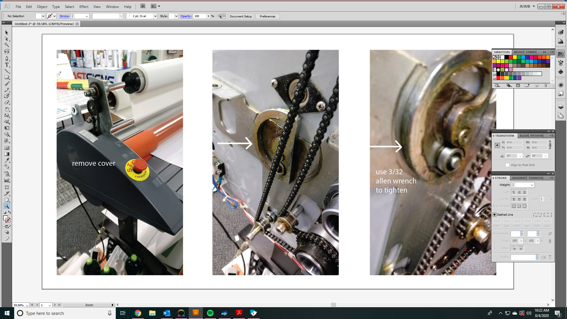

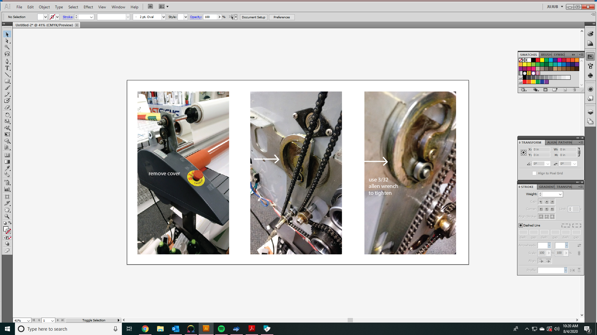

Our Royal Sovereign is ancient, and recently started having bad problems with bubbles on one side. We discovered that there was a tiny screw that was kind of loose. It seems to control the evenness of pressure across the rollers when the top roller is lowered. I'm not real sure WHY it works, but it has helped more than once.

For the record, we have a calibrator and we frequently calibrate the pressure side to side. The tightening of the small allen screw is good advice and I will do that. The Rollover applicator is also probably a good suggestion. I will look into that. Nobody commented on whether they could grab their top roller when it is in the open position and lift, and it moves up almost 1/4". Would anyone be willing to go try that? As always, I really appreciate the help. This forum is very helpful and I am always amazed how many people are willing to help a stranger.
Kudos for making that find!
