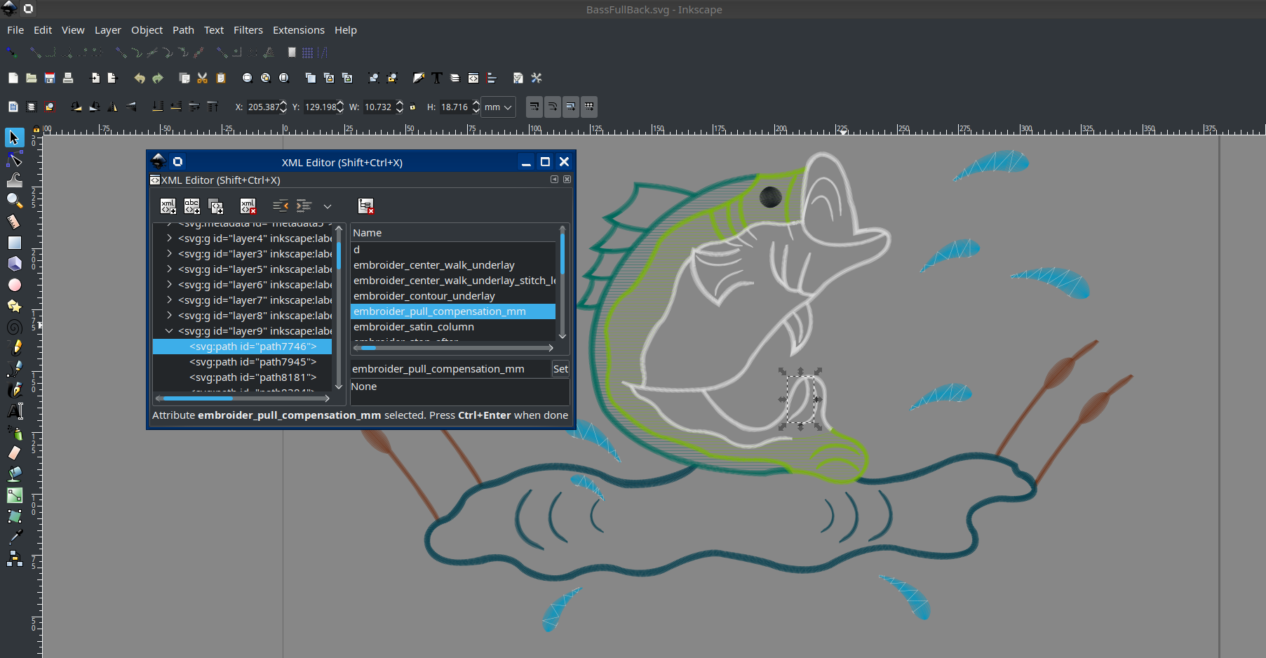

I doubt it'll ever be "needless", just because Ai and DRAW don't even support information that you see in the screen shot. Especially the embroidery info (right side info about the selected path), that will just be lost when bringing it into other programs. I use embroidery just as an example, there are other things that can be back into a SVG file in Inkscape that won't translate to Ai, DRAW and certainly not Flexi.
It's not the default format of those programs, that's also why rendering is a little wonky at times. Especially if it was created in Inkscape.

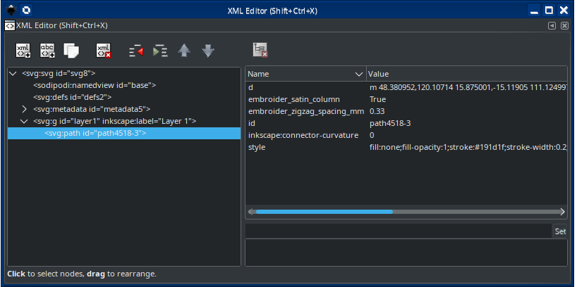

For instance, I'm a part of an open source digitizing extension for Inkscape. In SVGs generated by Inkscape, they are able to have XML attributes that Inkscape will save, but just ignores for it's own operations. But it still saves them.
If you were to take the same SVG and run it in Ai and/or DRAW, it's lost.
That's just one example and it may not apply to everyone here, but I'm sure that there are examples that would affect people along the same lines.
