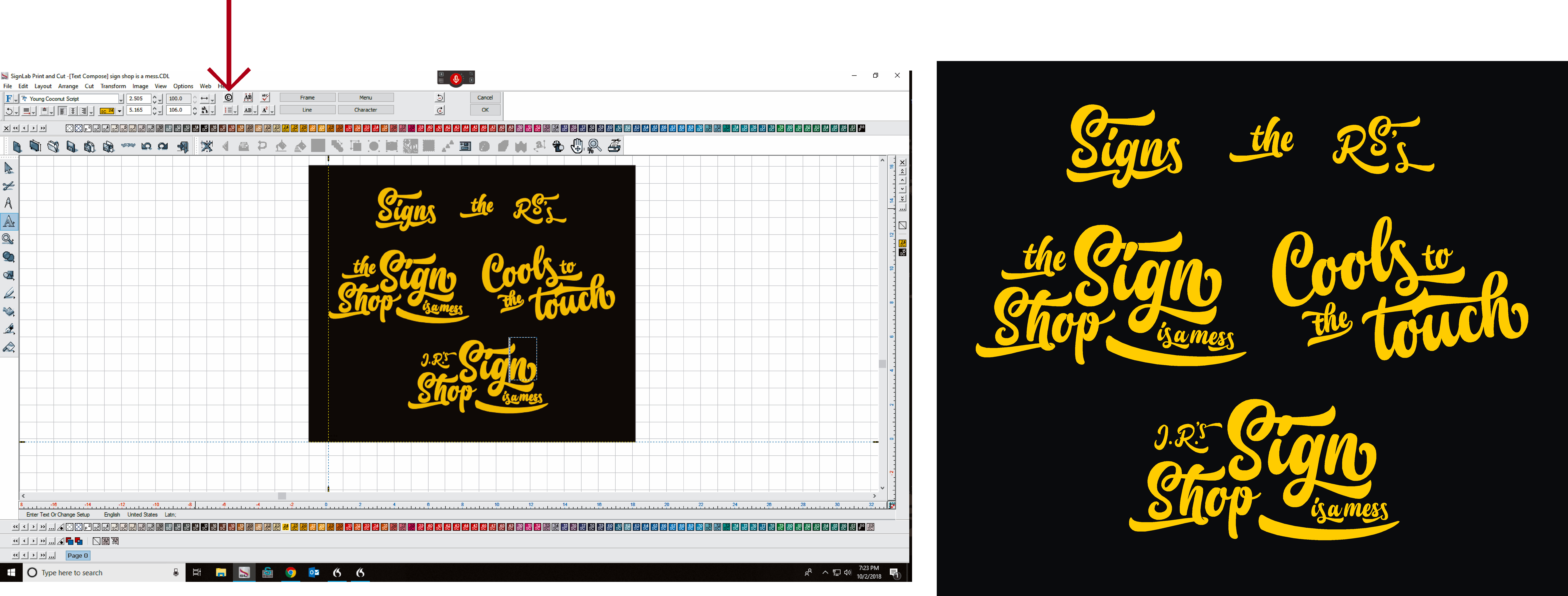

Sign lab 10 does have a way to go through alternate characters in a font.
It is called character picker. Take a look at the image it's that C looking symbol.
It makes it really quick and effortless to make cool layouts using alternate characters from the same letter style.
I know I'm answering my own question but hopefully it will help someone.
