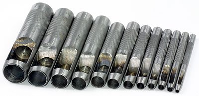

You might be able to find the right size in a gasket cutter set. They sell them individually also. Mainly used in automotive industry for creating your own holes in gaskets. There may be a tool out there, but that is what we have used in the past around rivets and dzus buttons on some race cars.

Yep...hollow punches, but these will cut the vinyl. You could always put it in a drill and file over the sharp edge so it works more like the tool you've shown.

Great idea. I bought a set of these last year at Harbor Freight for around $8.
