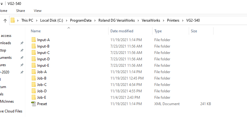

I use VW6, not Dual, but can't you set up a hot folder in VWD and drag your files into it? The files should then show up automatically in your default queue.

I just switched over to Versaworks 6, and still can only import files to the queue one at a time. Is that some default setting I can switch off?
Is it possible to setup a hot folder in Versaworks where it automatically imports jobs it finds in the folder?
It's been ~4-5 years since I've used it so can't recall. We use them with Onyx Quicksets all the time.
