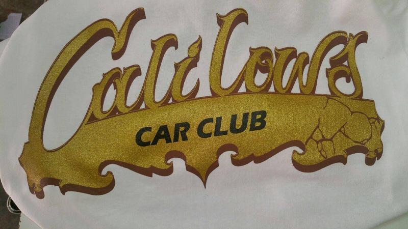

so a customer sent this image over to me and asked if it was possible to do a gold sparkle effect. i think its possible but i dont know how lol. has anyone tried doing this? and if its possible can someone direct me to a link or post steps please? thank you in advanced.
below is the pic of what i mean by the sparkle effect.
http://cienel.net/photoshop-tutorials/50-sparkling-gold-effect-photoshop-tutorials one of these should work

No need to print on gold. Print on the lightest metallic silver you can find. If you want excessive sparkle print on Aver Ultra Metallic. I do this all the time and it works very well. Your inks are translucent so whatever metallic content of the media comes right through.The lighter the colors the more metallic you see. The darker the less metallic.
Keep in mind that silver changes your white point and yellows will tend to be brassy. Just use a pale yellow for gold. If you do it right the results are nothing short of amazing.

thanks guys but they want a banner, the photoshop effects worked great. im not trying to actually print sparkles just the effects like that in the picture.
I've used Avery Supercast Metallic White with great success.

No need to print on anything special nor paint or do any photoshop tricks. Just print it on your preferred vinyl and laminate with avery 6040 sparkle lam. DONE
