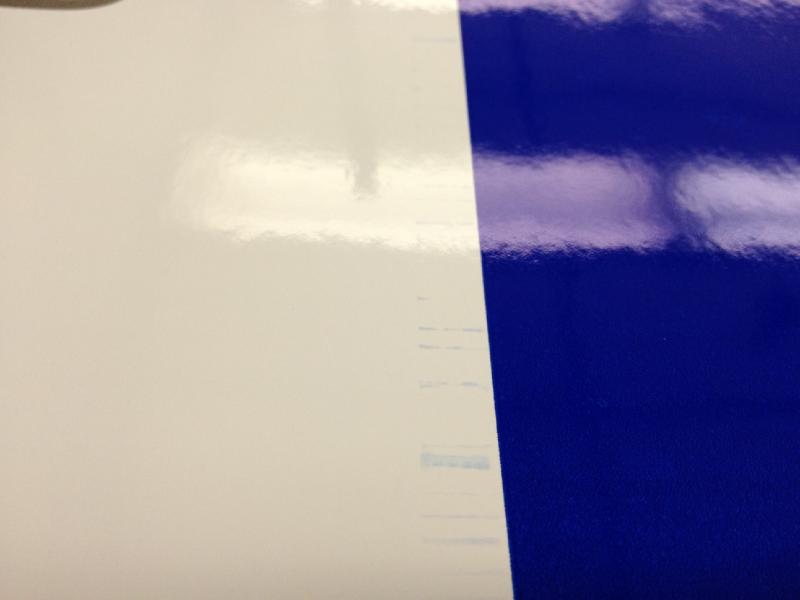

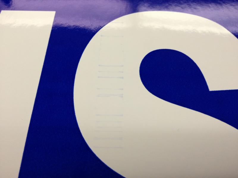

Ink laying where the roller was? it looks like the roller rolled over wet ink and did this but that is not the case. this only happens for about the first foot of the first print like over spray then the rest go fine. it happened yesterday and then all the rest were OK same file this morning same thing heat is set at 45 C and 45 C, High pressure on the suction , head is low material is oracal 3551GAR. any ideas?

When you're not using the printer, do you leave the lever open or closed? I ask because I'm wondering if there isn't some ink on your lower pinch-wheels that's being transferred to your upper pinch-wheels.

lever open to prevent flat spots. the wheels have never touched the ink I have not cut anything unlaminated so no ink has ever come into contact with the rollers. I have only had the machine a couple of months and bought it new. Roland SP 540I

definitely looks like ink transfer from the pinch rollers.
OR possibly a piece of "fuzz" (hair/dust/fiber) under the print carriage, that's wicking freshly printed ink.
OR possibly built-up ink "gunk" on the cyan printhead that's scuffing the media on each pass? error in that one-line only could be also result from a slight buckle of the media due to too warm a pre/print temp for the media.

That looks to me like overspray sticking to the rollers due to static. What's your humidity level in the shop?

it is not an issue of dirty rollers I think Donny has it with static the wheels never touch the print. The ink is attracted to the area that the rollers rode over after the fact.
