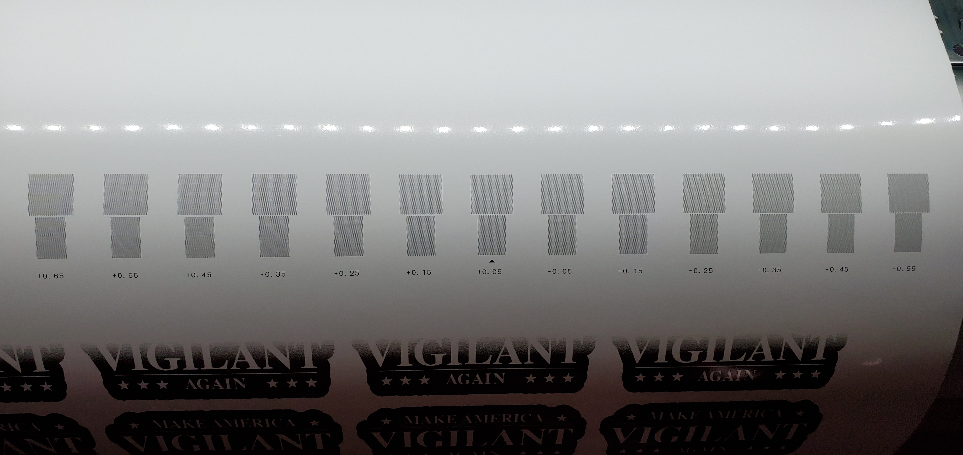

is this feed calibration correct?
bigkahuna_305
im having issues with blurry print every other row. any thoughts?

You want the black squares to be touching without any overlap or gap. Input -0.55 and then print another pattern. It will be closer and then adjust from there.

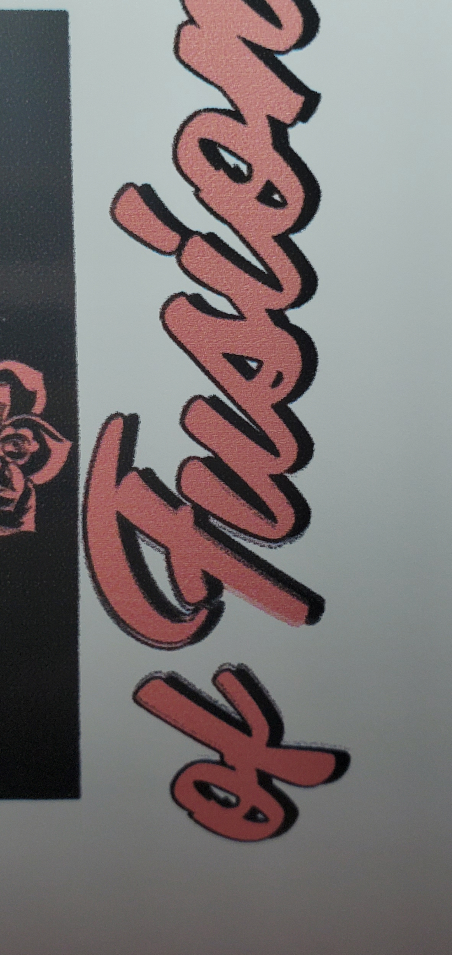

just did that and it printed much better just a little blurry on a couple spots above and below the design so adjusting it again and trying. will post a pic shortly. When i did reprint the test it showed 55 as touching and to the left they all looked the same its very weird
bigkahuna_305
so i did -55 and the next set they were all touching. i did a print and this is it now

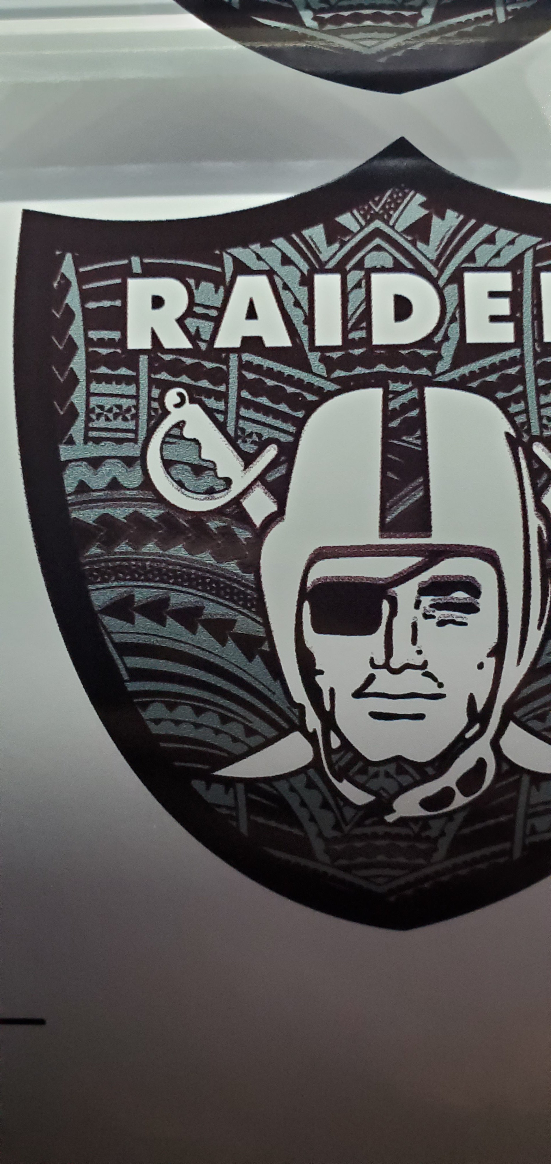

so now its the bottom of my designs that are having a miss print
