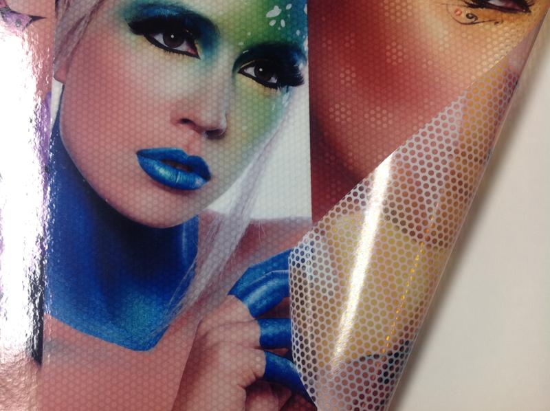

Customer wants window perf installed indoors to be be viewed from indoors. My concern is that the light from outside is going to make it hard to see the printed images? Is this really going to be a problem? The indoor room has lights facing the grid of windows that are going to have perf installed on them.
This material would be ideal for that application, it applies to the inside and is viewed from the inside. I sell this material so if you have any questions just let me know.
