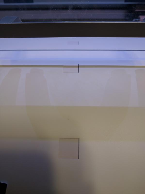

Is this normal? Pic
-Fusion
Vg540, 4 weeks old.
I calibrate to have perfect cuts then print 5 6x8 sheets across twice. And now look at how the print test looks.
What am I doing wrong? I have tried a new roll of Orajet 3621, reloaded, with only 2 pinch rollers, 4 rollers, changed temps and I can't figure out why after 10" of media it's this off.
Help please.

I had this problem with 3M IJ10, but no other media (VS-540).
Ended up using it in another machine and never ordering another roll of it.
Hopefully you have a different result.

I think we need more information about this project. Kinda hard to follow you.
5, 6" x 8" squares, cut routines runs twice? and I see it is slight off to one side, right?
Running crop marks? using heat while you cut?
