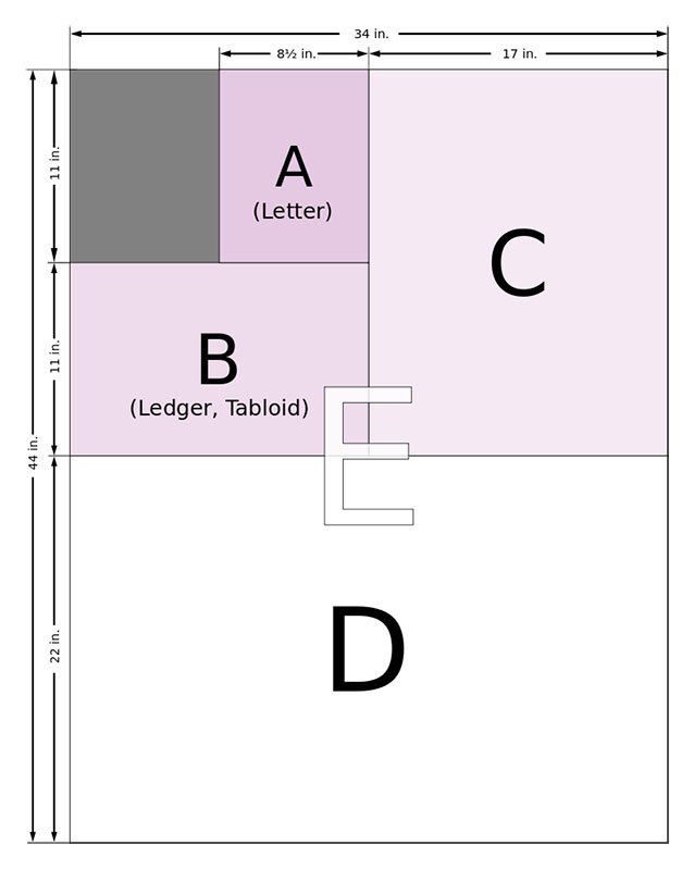

More than likely, when you are loading as cut-sheet media, the printer is assuming that standard sized (ANSI or ISO) sheets are being used. ANSI for example a standard ANSI C cut sheet is 22x17 inches.
I would load as a Roll instead which is undefined in the length direction. You are probably better off sticking with roll media vs cut sheet.
With the HP Vivera pigment ink in that plotter, you must use aqueous-coated media, as the inks will not bond with uncoated products.
