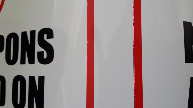

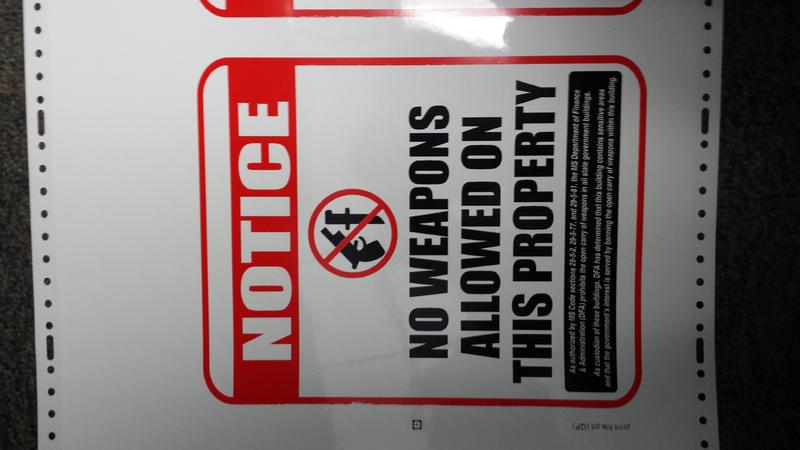

I am printing black and red (zero 9 ribbons) on to FDC white static cling. The black prints fine. The red border prints fine on the top and bottom but is rough/fuzzy on the left and right sides. Any thoughts?

The problem is almost certainly that the combination of the red foil and the cling don't get along. I would almost guarantee that if you use a Gerber red foil there would be no problem. Try a different red foil.
