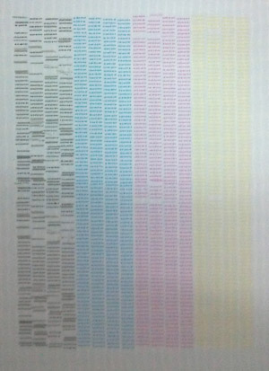

Hello, my name is Joseph and this is my first post. I am having an issue with my Roland SP-300V printer. My prints have been recently fading on the black and return to normal after a cleaning. The next day the fading will happen again and would return to normal after a cleaning. After I did a normal cleaning, I performed a test print. Attached is a test print after the most recent cleaning. Does anyone know what the issue might be?
According to my research, it seems to be clogged nozzles and possibly damaged nozzles. Will I need to replace the head?

how long with the old caps and dampers?
About a year. I am unsure what to check for when inspecting the caps and dampers. What I did notice upon inspection of the wipers is that the absorbing material has small perforations like a fork was used to poke holes in it. The wipers are warped a little and had dried ink on them. I cleaned the wipers prior to the issues.
