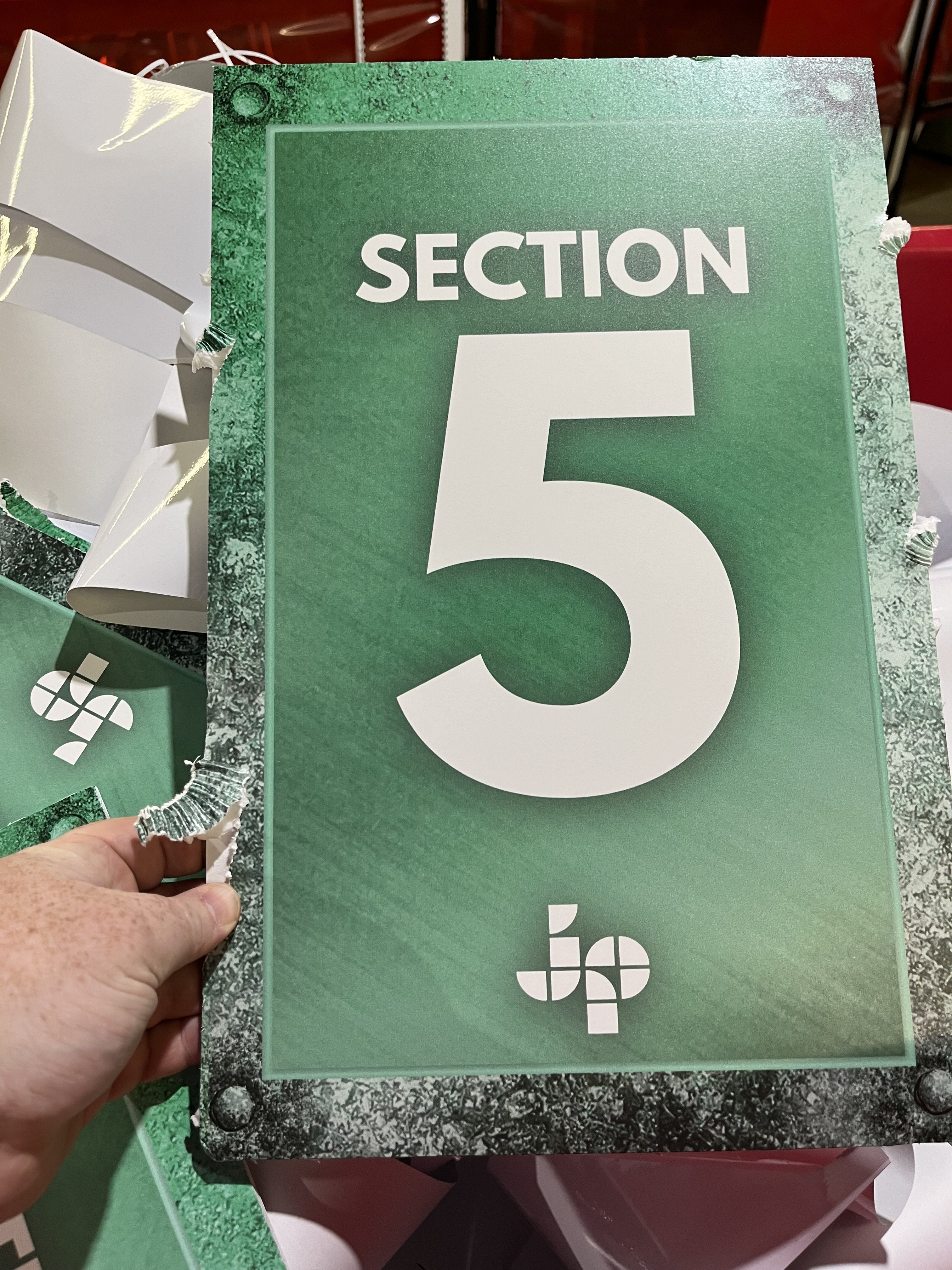

We have been cutting foam core on our Colex for years and never had any issues. A few months back we had a small job and it started tearing the face and/or the foam. Now it happens every time we cut foam core. We tried single and double edge blades, same result. Tried brand new blades, same result. We have always used the same setting but also tried other settings, same result. Tried speeding it up and slowing it down, same result. Let's say we have 5 images across the sheet, it will cut 3 sides of one piece fine then rip the last side, next piece, same thing but a different side will rip, next piece, 3 sides will rip. There is zero consistency. I thought maybe the material we had was bad so we bought more, same result. What are we missing or doing wrong here? Would be curious to know what settings others are using for foam core.

Could it be heat (friction)? I don't have a Colex but I know that friction can warm up foam and pvc to the point of becoming sticky, which could cause tearout.

I agree with Petepaz. Something out of alignment. My guess is the blade is not straight. It if it even slightly off your not cutting with the sharp part of the blade, you are dragging it across the material. Check blade alignment and the blade holder to make sure all the screws are tight.

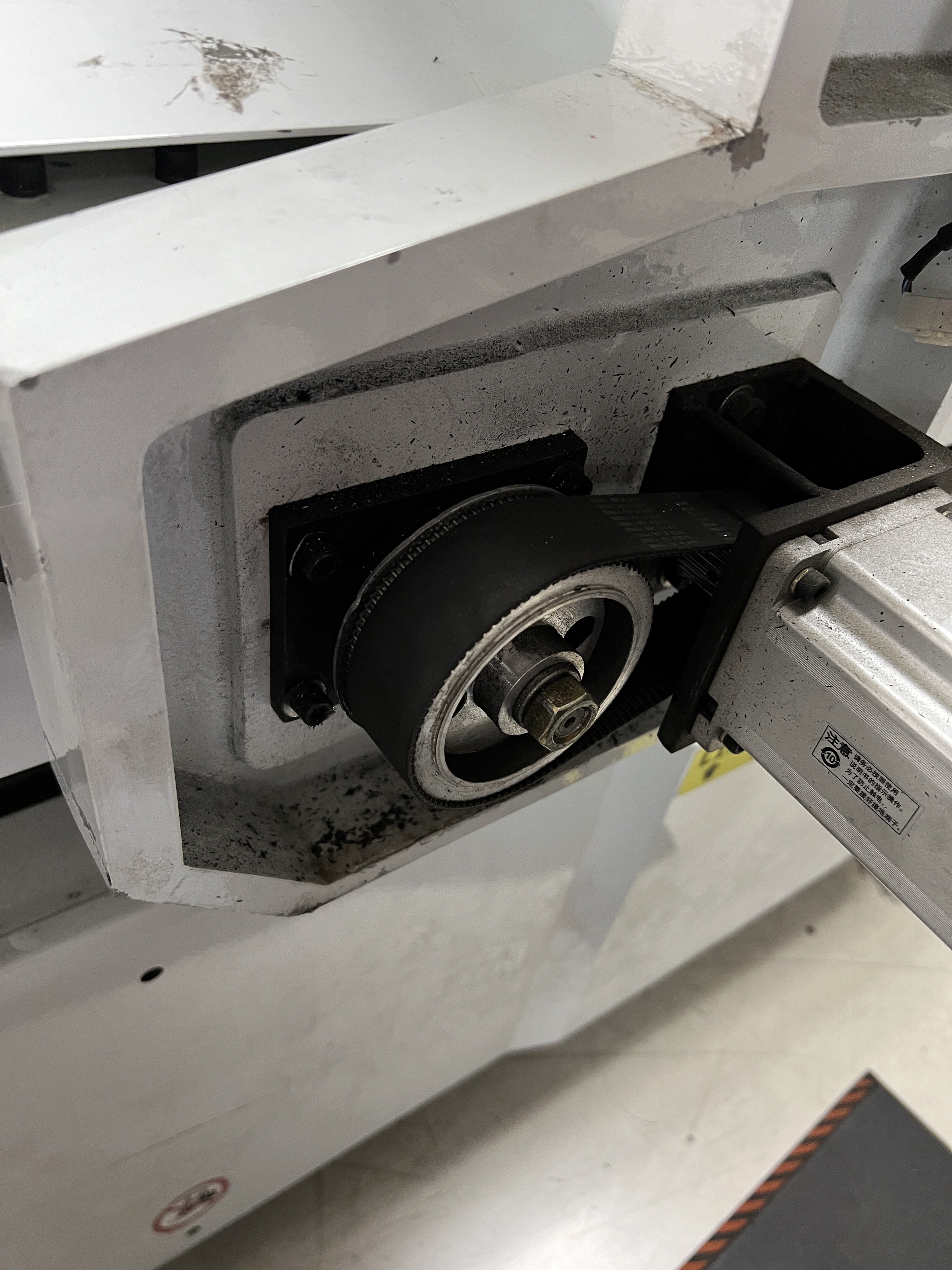

We had a drive pulley with bearings that were shot. Our machine is a 2015 model and was becoming inaccurate on some more intricate cuts. So check slack/play/give in the gantry on both sides to see if something's loose. At first I wanted to blame vacuum, then the camera, but I checked that everything was tight, and it wasn't! We have a new part arriving today. Thankfully for anything squarish, it's cutting accurately.

Interesting, we have some similar issues and ours is an older machine too. Did you buy the part from Colex? We took the covers off and the belt seems tight, gonna run in a bit with the covers off and see if it looks like the bearings are having any issues.

Yes, the part in the photo, which is the large pulley and bearing, plus a fresh belt, is due to arrive today for install. Both are coming direct from Colex.
