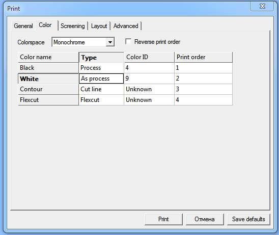

Do you print with Color Control? You need to assign white as a spot color in Color Control.

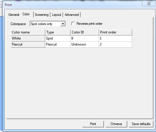

Yes, I am printing from Color Control. In the photo, you can see the Color Control configuration, where the printer only cut but did not print. I also don’t understand why Color Control displays black, even though there is no black color in the file.

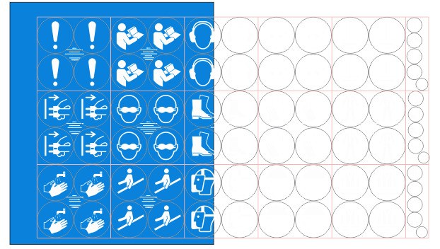

In the photo, you can see the file I am sending for printing and cutting. The blue color on the left was added for better visualization in my example.

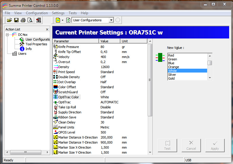

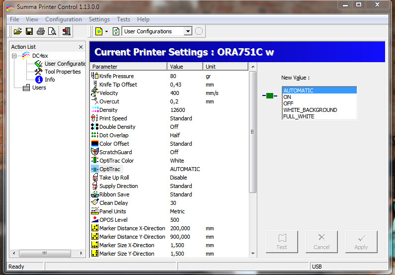

In Summa Printer Control 1.13.0.0, there is an option to select OptiTrac Color - White and OptiTrac - AUTOMATIC. As you can see in the photo, I selected white for blue vinyl, but the printer failed to detect the marks.
I would appreciate your help with the settings so I can successfully complete this task.

FrankW
You should set the color space not to monochrome, and set White as a spot color (in the file too). Set OptiTrac to WHITE_BACKGROUND,
Bonlite
Frank, good afternoon. Everything worked out as you said.

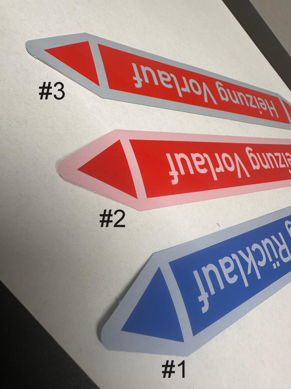

  1. How can I print white on colored films so that it looks white?The white color when printing on Oracal 751C-508 (signal blue) does not completely cover the blue and looks not white. - see photo #2.
    I also tried printing with a black mask under the white - now the white looks gray - see photo #3. I set the density to 14600 and used double density. I'm worried about tearing the ribbon. Could you please share your opinion?

FrankW
You´re welcome.
About white:

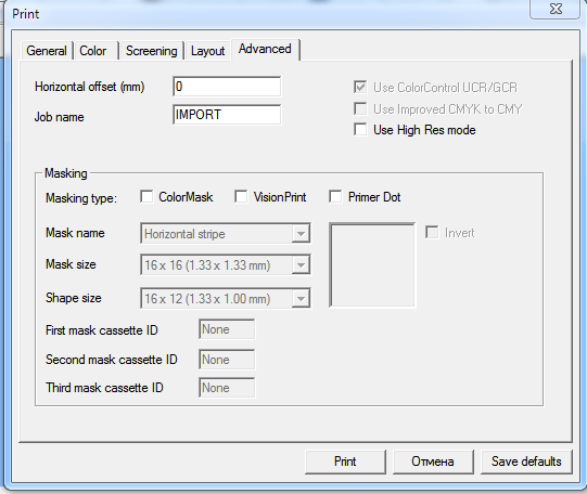

You can set Color Control to print more than one white layer. As far as I remember, you can set this in the "Advanced"-Tab of Color Control. If you post a screendump of this tab, I can show it to you.

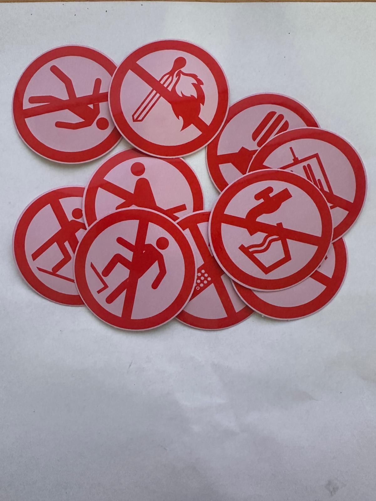

Good afternoon Frank. I have attached the bookmark you mentioned.

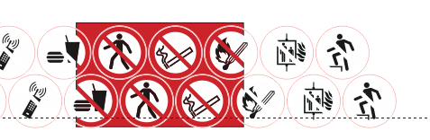

One more question—I want to print prohibition signs on red film (using white and black ink)- (For visualization, I placed a red background under the print file.) photoVerboten but when I select "Spot Colors Only"(photo Spot color only) mode in Color Control, black is not available. As a result, only white is printed.

FrankW
Not shure. I think it is a setting about "Masking". You have the possibility to set the cassette id for every mask to white.
About the red signs: set black as a spot color in the file.
For white – assign a mask to white so that it is printed twice?
For black – do you mean selecting any spot color for black in the file and then changing its number in Color Control, as shown in the photo?
