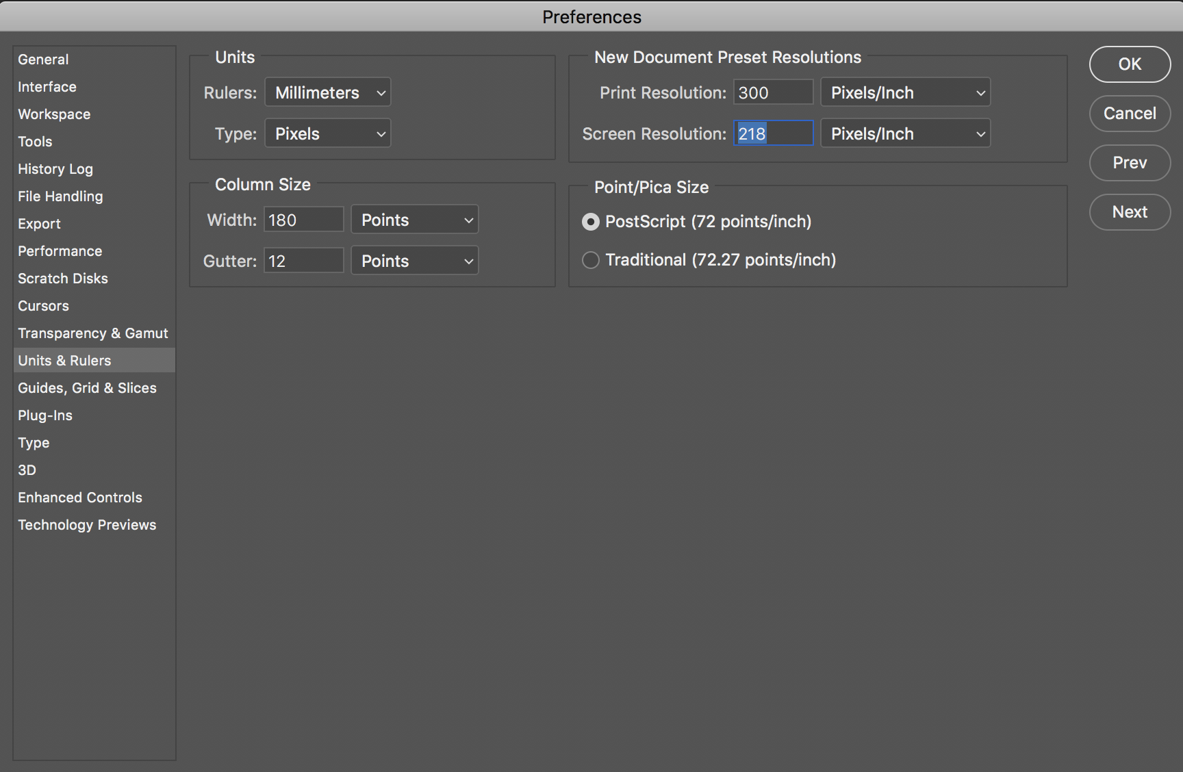

A common misnomer, but by DPI (dots per inch) you mean PPI (pixels per inch). Dots refer to printer droplets and not pixels. By itself DPI doesn't really necessarily mean much in terms of quality. Pixels are an indication of quality, but certainly not absolute.
PPI, on the other hand, refers to the internal resolution that is being displayed on your screen. Pixels can by subdivided, but that doesn't increase quality. You can set the PPI to 1 (no-downsampling checked), and print a 5000x3000 pixel image and it won't make a difference (Pixels=Data). (PPI= how big you want to display image on your screen.)
Think of it as taking a pie with 4-pieces and cutting those pieces in half to create 8-pieces. You still have the same absolute quantity and the quality of the whole hasn't changed.
A better way to judge quality is to set your resolution in photoshop to match your monitor (in my case it's 218ppi). Here's a useful website to do so. https://dpi.lv/ Then set (image size) followed by (view—>print preview) This way you can view all images on your screen at the exact size you intend to print them at and visually assess quality in ways that numbers cannot.
