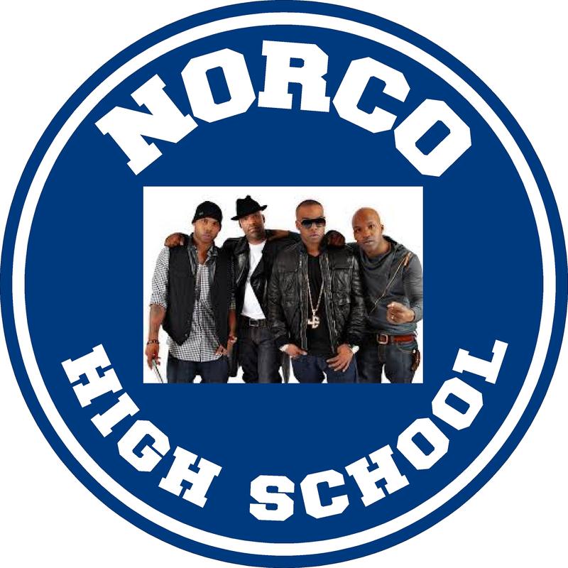

Am I going crazy and just haven't done a really large print in a while, or is it not normal for Flexi to display vector artwork with somewhat jagged edges? I've loaded a few different vector files, and they all are behaving the same exact way, even unmasked (though I don't think this would matter). I've seen this on AI, EPS, and PDF. Graphics card issue, maybe? Smooth screen display is enabled, by the way.

Is the issue in Production manager or in Flexi Design space? You may need to reinstall.
Or is this your issue?

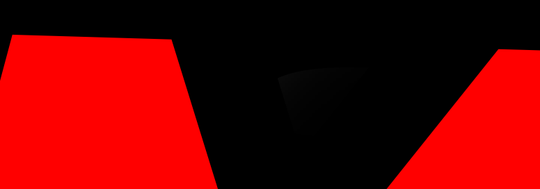

This is in design space. I never pay much attention to image quality in production manager, that's always crappy quality. Here's a sample. For what it's worth, I just opened the vector artwork in Photoshop to size at 100dpi, and it looked great at 100%. Saved it as a JPG, opened in Flexi, and it still had the similar pixelated look. Here's a sample of that JPG along with the actual vector PDF, both showing the issue I'm seeing. This is a huge 50"x25' print, so I can't really just pull the trigger and hope for the best.

This might be a dumb question, but is the vector straight? Because in the sample you just showed, it has the same jagged-ness as the JPG file. Can you show a wireframe of the vector art?

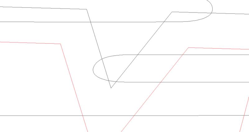

Uploading the images was compressing them horribly and not allowing me to show what it actually looked like. There's a lot of masks to this artwork, but here's the same section in wireframe mode.

eahicks
This is normal....you'd need a 4K monitor to lose the jaggedness.
Draw a line in Flexi, and change the angle of it several times. You will see the jagged sections change depending on the angle.
