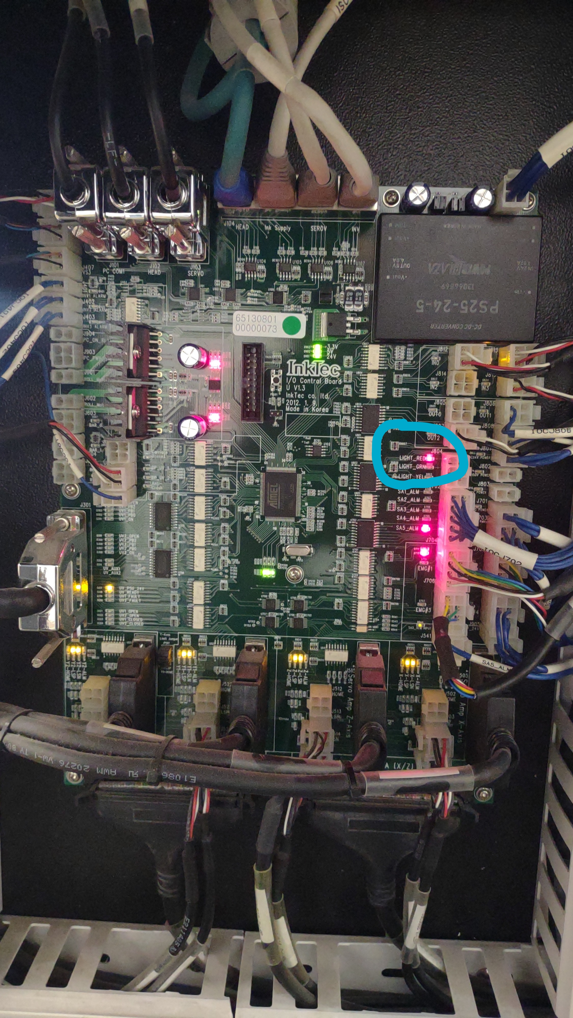

I accidentally touch the “head crush” bar when the machine was turned off (only the computer, not the breakers and entirely machine) and when I try to power it on, the computer start beeping (several times, like 25) and then nothing happened.
It would be helpful a photo of the controller board with the machine powered on without the computer started (only the breakers).
I suspect there is an issue regarding the safety circuit. I have some alarm LED’s on but I can’t figure out what happened.
Thousands of thanks.

Absolute. As I'm reminded in the starting post I suspect something in the safety circuit. That's why I need a picture of I/O controller boars, to see if mine is showing something abnormal.
After restarting it looks like in the 001_a.jpg (the circled one is flashing)
