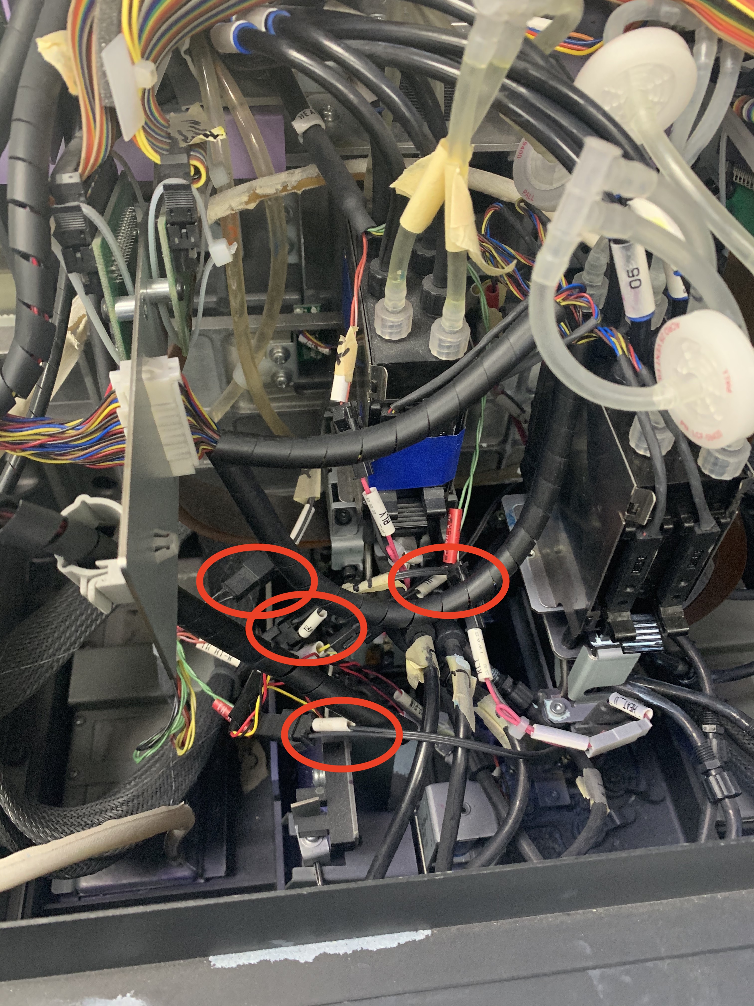

In trouble shooting another problem, we found and tested the ink thermistors. Perhaps this is helpful for you.
The ink thermistors are actually on the outside of the supply tanks/head assembly. They have two wires which could get caught in various things. You can measure the resistance of the thermistor to see if they are ok, or if the Heater PCB Is the problem. I can't remember exactly but I believe ours were ~6kOhm at room temperature. You can put your finger on the actual thermistor to watch the resistance change.
The wires are two wire pairs and labeled with "Th-" and there are two per head unit. The actual thermistor looks like a small metal rectangle screwed the to side of the head unit.
