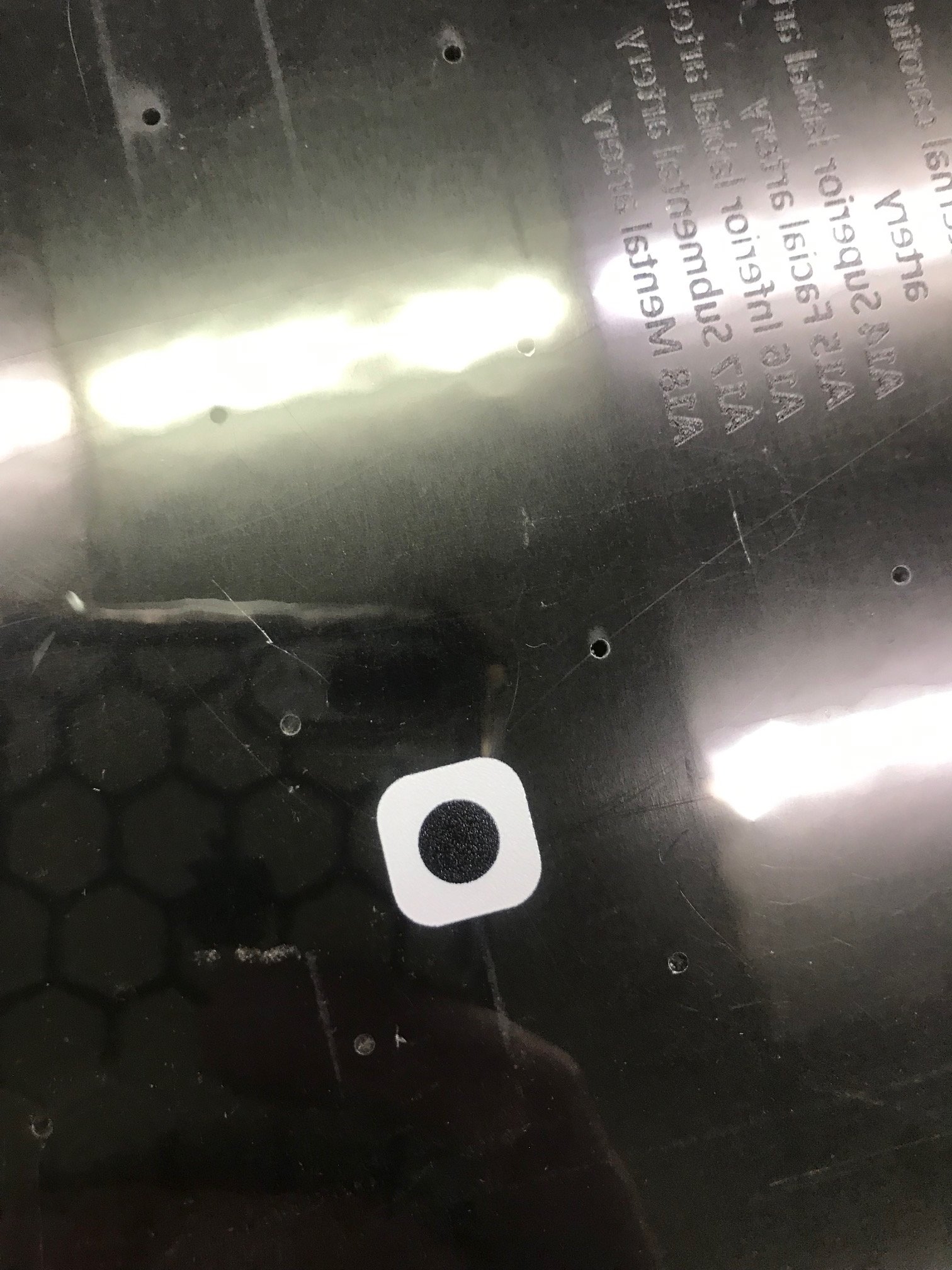

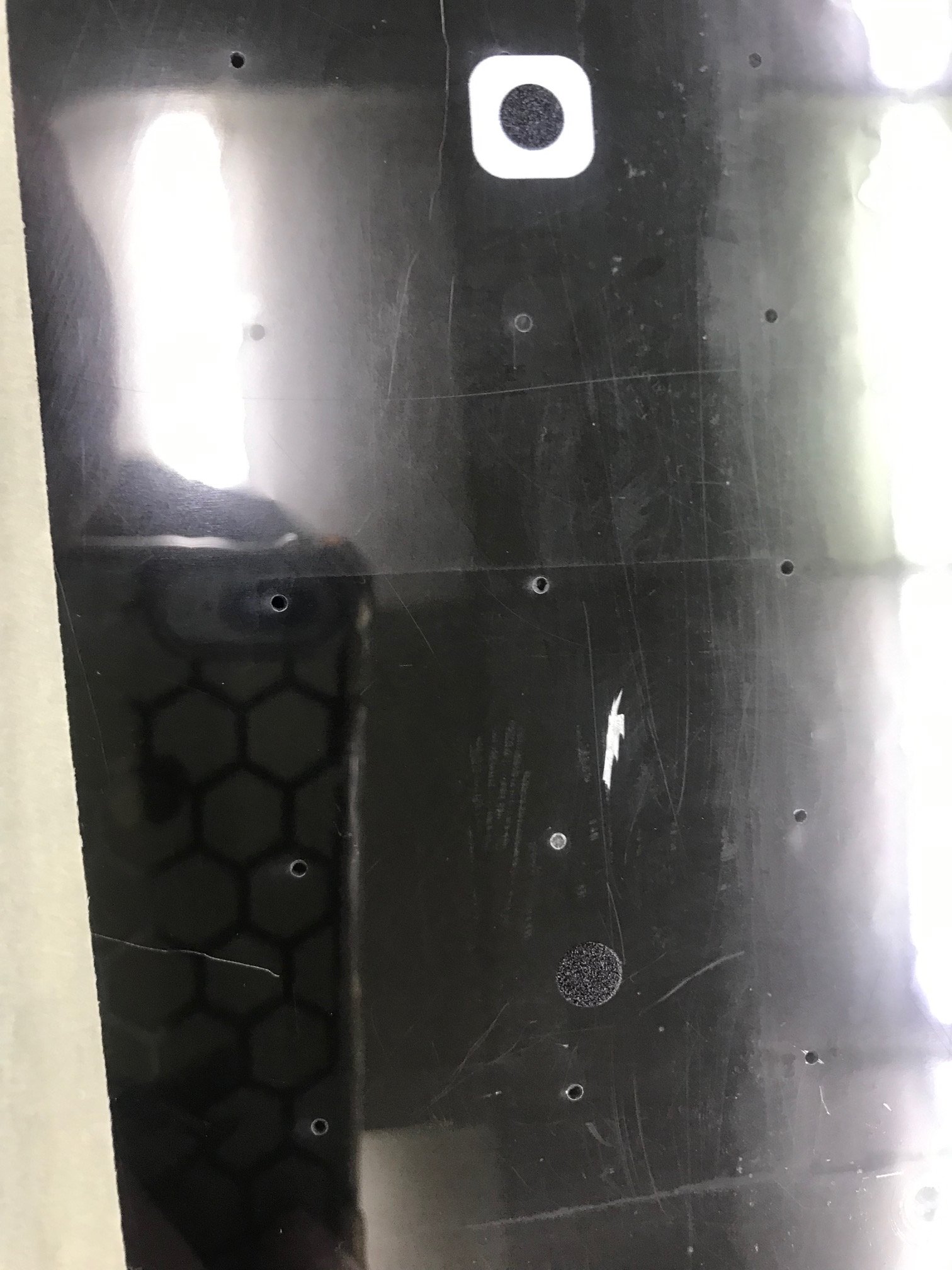

I am printing white around some registration marks so the Colex camera has an easier time reading the marks. I made the color around the registration marks a spot color and changed the color in the color replacement tab to print 100% white. This works on almost all marks almost all the time. The first 2 dots it prints has a 50% chance of actually printing the white, same file printing within 30 minutes of each other, sometimes it prints the white and sometimes the printer just says no thank you. When printing I am doing print only, I am not re-ripping everytime as these are large files and would add 10 minutes a print on top of print time. I have tried to reload the file, re-rip the file, change the spot color to a different color and nothing has worked.

This is not a huge issue as I can just throw a piece of tape behind the registration mark and it works the same. But this is just driving me nuts that the same file will sometimes print this white and sometimes it won't, AND it is only on the first 2 dots on the table.

The trick of it is I created a white plate and changed the color to white, and in both cases the white may or may not print. I am just racking my brain trying to figure this out. Like I said its more annoying than anything, and it's mostly annoying because when things go wrong I like to know why and I like to know how to fix it. But so far this may be the girl that got away...

It has only ever happened on these particular files for this one job. It's an overlay thing and there are 4 different overlays, so the same template was used and different art was just plugged in. And it has only ever happened on these 4. One overlay may print perfect on 10 beds, then the next will print one or two perfect and then not print the white on the first 2 reg marks on the next. I will say that once it stops printing the white it won't print it again, at least in the same day.
