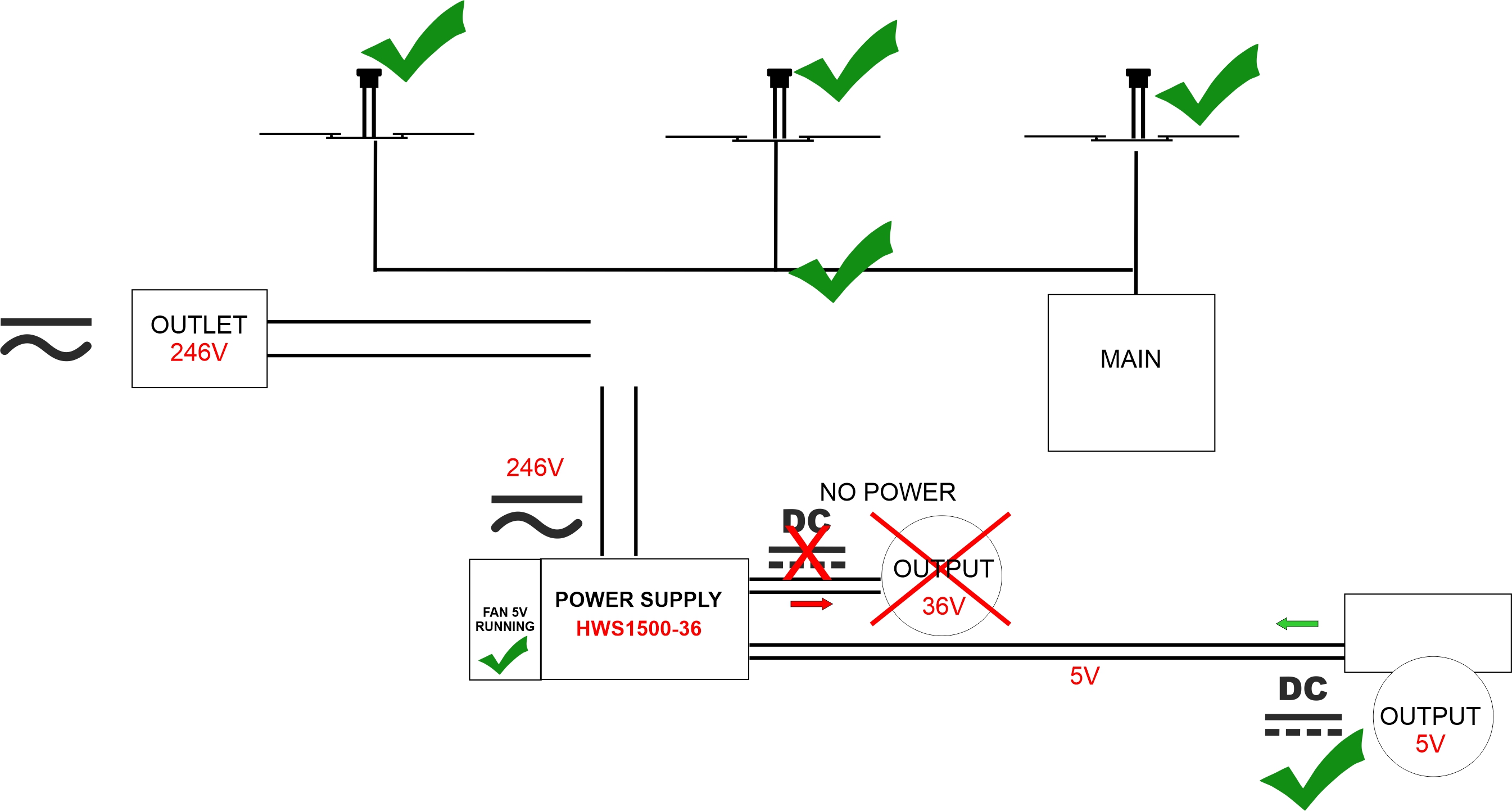

I would double check ALL the E-stops, your not getting voltage because of the e stops inherent function it sounds like
henry67
Yes. I have test all EMG switches. They are working good. No power output (36v)on the power supply. The 5V power input is good. See the picture below
