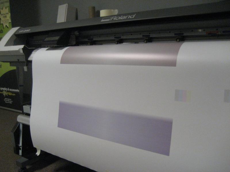

I'm printing three 30x90 panels on Oracal 3651 Matte to be mounted to polystyrene for a pop-up trade show display. It's a last minute job that is due tonight! Everything was going fine as usual. I printed a small scale test to make sure my colors were good. It looked great.
So I ripped the PDFs in VersaWorks using the same stock matte calendared profile I used for the test print. I ran one of the panels and it started out looking great. The top of the print has a brushed stainless steel alien skin texture. I got about 2 feet into the print (still looking great) when I accidentally scratched some wet ink in a solid black area... ruining that print. So I canceled it, and started over.
The next print started out fine, but then 6 inches into the stainless steel, the print started looking a little purple. I've canceled, reripped, rebooted everything, cleaned the heads, cleaned again, reripped again and I cannot get it to print like it did the first time.
Take a look at the attachment and you can see the first print that looks nice a grey and the 2nd print where the grey fades to purple. Now the
prints are solid purple.
Help! Any ideas??

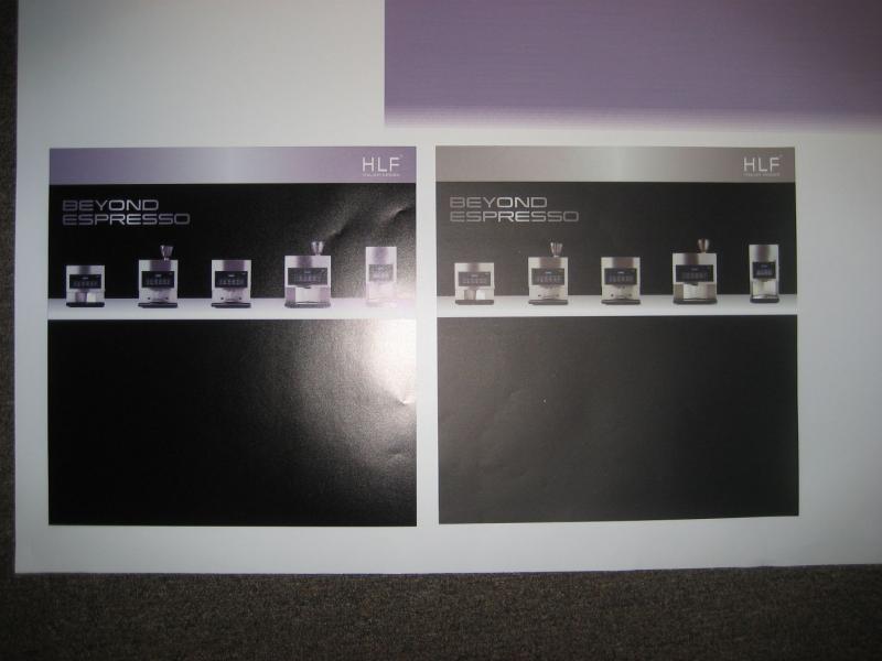

I don't get it... I didn't change anything... it just started fading to purple. I just reprinted my original small scale test... and it's purple too! Take a look.

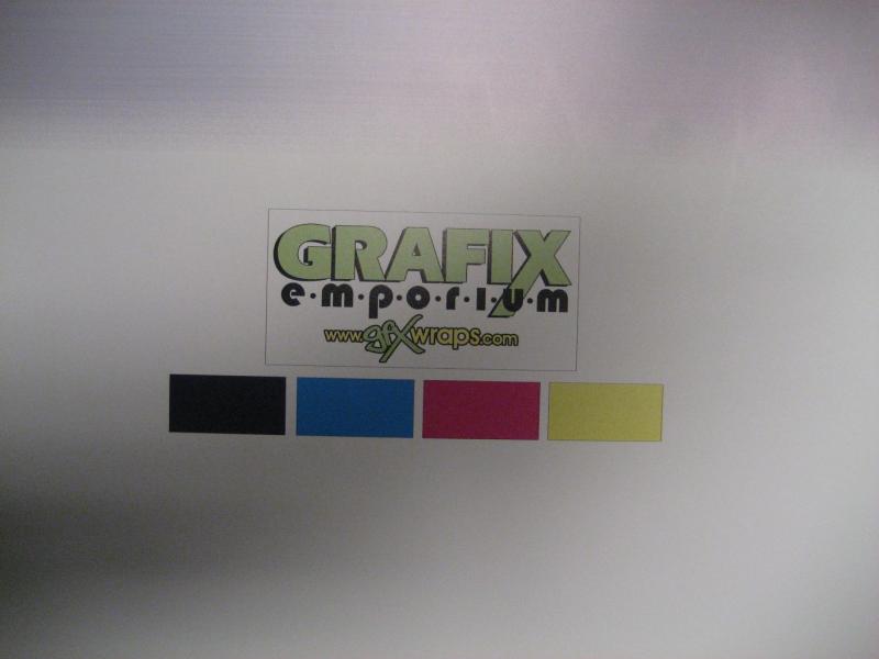

It could be a bad damper wich would cause one of the CMKY colors not to make it to the one of the heads. You should be able to run the test print to find out.
grafixemporium
I did print this before I shut down... it looks fine.
BorderPatrol... look at the test print image I attached before and this one. Even on the purple one... a majority of the print is solid black... and that part looks great.

Printed test... not all yellow is firing.
Yellow cartridge is totally full. Ran Medium cleaning... all yellow is now there in the test print.
Stay tuned...
Border
Well, if it's not showing low ink then I'd try cleaning first. If the cartridge ran dry then you'll probably have to run a cleaning after replacement anyways, to get the ink line filled again.
grafixemporium
You nailed it BorderPatrol. Thank you so much! The normal cleaning I did apparently didn't do the job. Guess I can't think straight when I'm panicking at 10pm.
